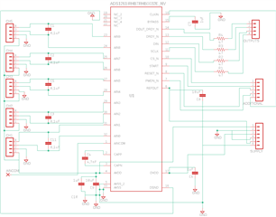

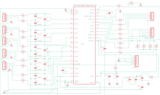

We are trying to develop a breakout board for ADS1261 which we will be using for our in-house built force platforms. We have designed two circuits for the same, please find the attachments. Design-1 is based on the layout mentioned in page no. 82 of ADS1261 datasheet (https://www.ti.com/lit/ds/symlink/ads1261.pdf?ts=1747206472285&ref_url=https%253A%252F%252Fwww.ti.com%252Fproduct%252FADS1261), and Design-2 is based on the circuit diagram provided in page no. 25-26 of ADS1261 EVM user guide manual (https://www.ti.com/lit/ug/sbau293a/sbau293a.pdf?ts=1747133881840&ref_url=https%253A%252F%252Fwww.ti.com%252Ftool%252FADS1261EVM). Kindly help us to understand which circuit is appropriate to go ahead with for designing the breakout board for ADS1261.

    I could not see any difference between two block diagrams you uploaded. Page no. 82 in ADS1261 datasheet shows a PCB layout, but page no. 25-26 in ADS1261 EVM user guide shows a schematic, so can you clarify what the difference between your two circuits is?

  • Sorry for the mistake. Here are the two design
  • Hi Charles,
    Thanks for your clarification. The figure 103 in no. 82 of ADS1261 datasheet focuses on a layout example, the circuit in the figure is a simplified circuit. The circuit in the ADS1261EVM user guide is a practical and recommended circuit. For example, not only a differential capacitor but also common-mode capacitors should be used, see the guideline [FAQ] Delta-sigma ADC anti-aliasing filter component selection
