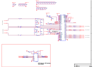

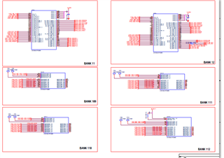

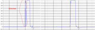

Dear Sir,
We are finding same time glitches in captures from the HSDC Pro using the demonstration GUI. Please find attached images and  custom board schematic.
Kindly suggest the how to resole the issue.
Software Tool: Vivado Ver 22.2
GUI: HSDC Pro
Nanjegowda
  • Hi Nanjegowda,
    Just so I understand correctly, you are sampling a pulsed input signal? Is that the first plot with the glitches?
    If so, can you send over better quality pics of the schematics? And more of the circuits that connect to the analog inputs?
