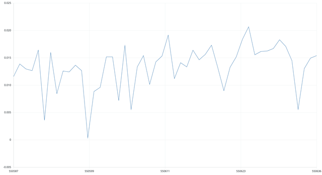

I am using the following components which I intend to sample a differential signal of between 0V and 400V at 100ksps.

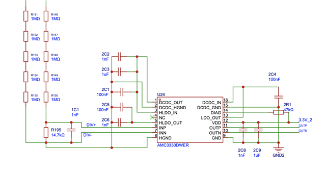

- Voltage divider of 10M/14.9k (5 x 1Mohm, 1 x 14.9kohm, 5 x 1Mohm)
- AMC3330

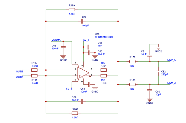

- THS4521 (with OPA320 reference buffer)
- ADS8354
Of the ADS8354 I have CFR.B6 = 1 and CFR.B9 = 0 and am sampling at 100ksps.

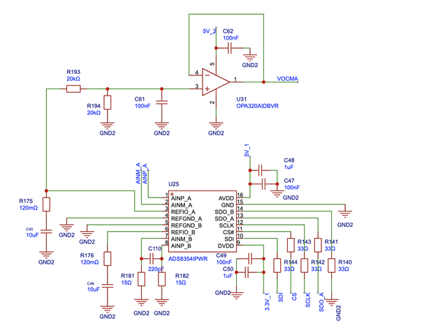

I have a 20k/20k divider between the ADS8354 REFIO_A and OPA320 to provide a CM of 1.25V.
Currently I am sampling a 5V DC supply, not the intended 0V to 400V differential input, as I have just received the boards.
The issue is, using a DMM at AINP_A and AINM_A I get a steady 13.78mV. The ADS8354 however shows a sporadic value of between 0V and 25mV.

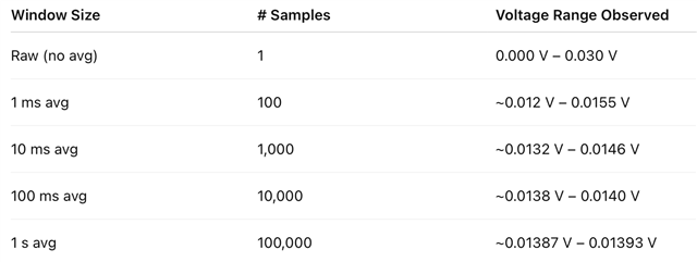

If I sample at 100ksps, and the average into 1ms, 10ms, and 100ms the noise disappears.
If I short the AINP_A and AINM_A I get one to two LSB, so there is no issue with the ADS.
If I short at the AMC OUTP and OUTN I read between 0V and -1mV, but mainly around -600uV.
Each DVDD and AVDD has its own LDO (LT3045)
- AMC3330 = 3.3V

    Could you perhaps also look at how the Vocm looks like, both at the output of the ADC (REFIO) as well as after the OPA/input of the THS?
    Also when measuring the AIN pins could you make sure that the common mode the ADC inputs are seeing are withing +/-100mV of VREF/2 or VREF?

    With DMM:
    • REFIO_A to GND = 2.4997V
    • Pin 3 of the OPA320 to GND = 1.2498V
    • VOCMA of the THS to GND = 1.2499
    When shorting at the output pins of the ACM3330, the rough -600uV (0 to -1mV) is what is seen on the microcontroller serial monitor, as read from the ADS8354 over SPI. The 1 to 2 LSB seen when shorting directly at the ADS8354 was also measured with the microcontroller over SPI.

    I also did forget to mention sorry. I Have shorted the input INP & INN on the AMC3330, and the noise did not resolve as it does when shorting the OUTP and OUTN of the AMC or AINP_A and AINM_A of the ADS.

    From what you mention about seeing the same noise when the input of the AMC3330 are shorted, but not with the THS nor the ADC I would think maybe there could be an issue there.
    Let me add a colleague that works with the AMC3330 to see if they can help with this issue.

  • Hi Dave,
    AMC3330 has an internal chopper that operates at 625kHz, this is a potential source of the noise. I would recommend increasing the capacitance of C79 and C78 a bit to help attenuate this noise.
