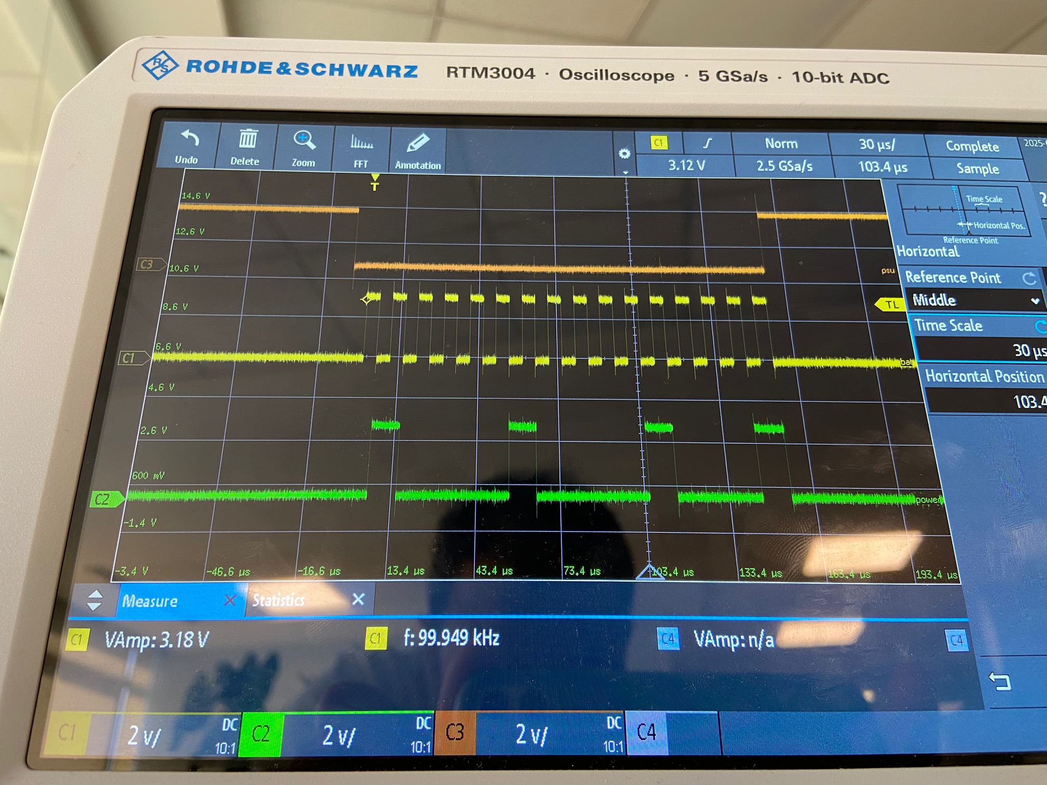

I am currently working on integrating the ADS8686S ADC with a FTDI FT232H USB-to-SPI bridge and encountering issues while trying to read the Device ID (Register 0x10) via SPI in software mode. Despite verifying signal activity through an oscilloscope, I am receiving incorrect or inconsistent values (e.g., 0x0002, 0xFFFF, 0x0000) instead of the expected Device ID.

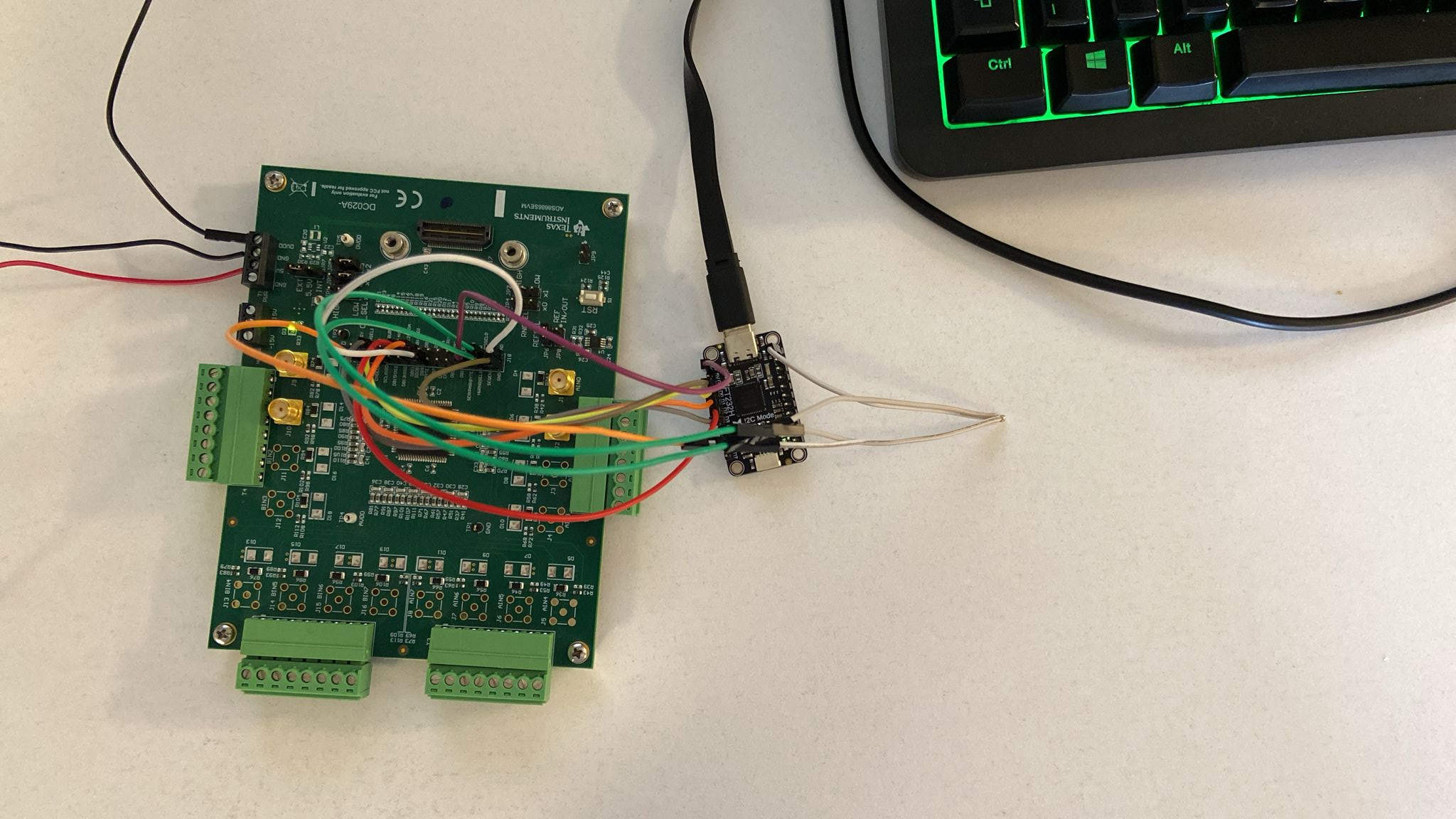

Hardware Setup
ADS8686S Supply:
5.5V → T1 PWR 5.5
3.3V → T1 PWR DVDD
FT232H I/O Voltage: 3.3V
Shared GND between ADS8686S, FT232H, and power supply
Pin Connections
ADS8686S Pin FT232H Pin
SER/BYTE/PAR (J18) 3.3V
DB9/BYTESEL (J18) GND
HWRNGSEL0 (J18) GND
HWRNGSEL1 (J18) GND
SCLK/RD (J18) D0 (SCLK)
DB10/SDI (J18) D1 (MOSI)
DB12/SDOA (J18) D2 (MISO)
CS (J18) D3 (CS)
Note: R23 resistor on the ADS8686S board has been removed to allow SPI access.

SPI mode tested: 0 and 2
  • Mode 2 (CPOL=1, CPHA=0) returns 0x0002.
  • Mode 0 returns 0x0000.
  • Oscilloscope Output: Confirmed proper SCLK and CS timing; data is transmitted as expected from FT232H.

    Welcome to our e2e forum!  Can you post the ADS8686S o'scope screen shot you mentioned above?  To your questions:
    1. Yes - timing could be an issue, you also may need to fully configure the data-bus pins for serial mode.  There are a number of pins that should be grounded and the ADS8686SEVM takes care of that via the PHI controller card, which has to be disconnected before you can use your controller.
    2. SPI mode 1 or 2 would be appropriate.
    3. See 1 above, also make sure you have a way to control the RESET pin.
    4. Unfortunately no.
    5. I am not aware of any issues using the FT232H with the ADS8686S.
