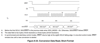

    Have you confirmed that the output of the ADS127L11 is incorrect?  Please capture the SPI data frame using an oscilloscope or logic analyzer and provide a picture.
    /DRDY, /CS, SDO, SDI, and SCLK would be helpful.
