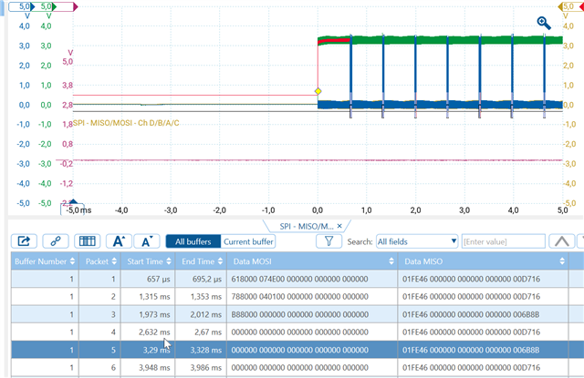

i have a big problem to configurate the AMC131M03 device.
I'm setting up the SPi communication with FPGA Xylinx Artix 7
ADC Clock 6.25 Mhz.
 I'm sending at first 2 configuration frames. After i send all the time NULL Frame.
1) Clock Div setting see frame number one below
2) DCDC see frame number 2
Could you please help me to find my failure!! Thanks in advance.

    Please configure the DCDC according to figure 8-3.  Figure 8-37 wasn't updated from a previous revision.
    Also,  Is your MISO line reading correctly?  The data in the picture doesn't match what the device should output.
