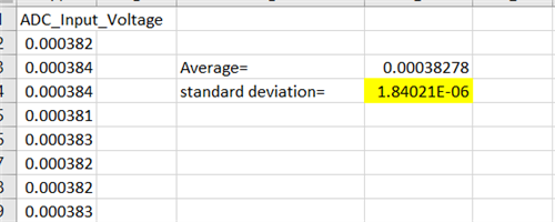

    Since ADS131A04 is a simultaneously-sampling ADC, so you can short the input of each ADC input channel, then analyze the data to check the offset error and the noise on that specific channel.

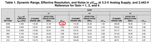

    I checked the ch2 data in the first excel file you shared, the RMS noise of your ADC circuit is 1.84uV as you can see the result in the following image:
    I believe you are using Gain=1 on ADS131A04, so the RMS noise at 1ksps and gain =1 should be ~1.82uV as you can see the value highlighted in the table below, so your measured result matches the ADS131A04 datasheet, this indicates that your circuit design of the ADC including coupling, power supply and the layout works as expected
