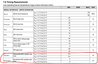

I would like to know what is the maximum output voltage update frequency (settling rate) of the DAC81416. Specifically:
  • What is the maximum update rate when only 1 channel is actively updated?
  • What is the update rate when all 16 channels are updated simultaneously or sequentially?
Any details on the settling time, SPI interface limitations, or other factors affecting the update speed would be greatly appreciated.
Thank you!
  • Hi Lex,
    Please check the 7.6 Timing Requirements section.
      • wait time between two code updates is 2.4us minimum.
      • wait time between two code updates is 4.0 us minimum.
    Here the wait time defines as the diagram below -
    Now the update rate can derived from the equitation below -
    Update rate  = 1 / (wait time + time from the CSz fall edge to CSz rise edge)
    Even though the settling time is 12us, DAC can be updated with faster update rates. Output will change but it wouldn't be settled.
