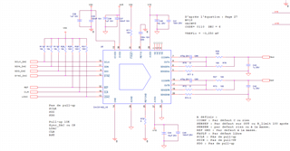

Hello, we have just implemented the DAC81402 converter in our assembly, driven by our STM32G431CBU processor.
Of course, we were inspired by the assembly of your DAC81404 Evaluation Module and BP-DAC81404EVM, BP-DAC61402EVM test boards.
We want to use it in bipolar + or - 10VDC mode. For the moment, we have validated its power supply and started programming (initialization and control), but we are unable to generate output voltages.
Although we have verified and measured it, could you please confirm our schematic?
Also, here are our lines of code

  • ha yes i forget, R76 et R73 are absents
  • Hi Laurent,
    Schematics looks to be okay and the the code doesn't looks proper.

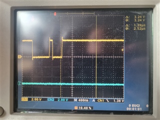

    We are generating SPI frames on the SDIN, SCLK, and SDIN busses, but we are unable to get the converter to work. Initially, we are unable to initialize it.
    We are using the internal reference. We don't have 2.5V in REFIO?

    SDIN at the top and SCLK at the bottom
  • HI Laurent,
    I think you are skipping the step a) Write 0x0A84 in SPICONFIG (0x03) -  to power-up the DAC81402 device. Please check again.
    Also it's very difficult for me to make sense from the scope capture. Please share the scope snapshot of the SPI signals - CSz, SDIN, SCLK and SDO in a single frame for write commands mentioned below.

  • Hello Sanjay, and thank you for your feedback.
    I'm not well-equipped with an oscilloscope; it's not recent, and I'm missing some waveforms I ordered. I don't have an analyzer, so for now, I'm validating the signals by alternating between viewing the SINC and SDIN signals. Actually, I wasn't configuring SPICONF. I thought it would be valid by default, and I'll look into that...
