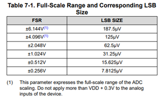

    Just another question about ADS1015 gain.
    I read a comment in an example code from Adafruit, like this:
    // The ADC input range (or gain) can be changed via the following
    // functions, but be careful never to exceed VDD +0.3V max, or to
    // exceed the upper and lower limits if you adjust the input range!
    // Setting these values incorrectly may destroy your ADC!
    Why setting the ADS1015's gain can destroy the ADC, and how to avoid it?
    Thank you and best regards,
    Tuan Tran.
  • Hi Tuan,
    Table 7-1 shows the input ranges of the ADS1015/ADS1115. An input higher than the positive full-scale won't harm the device. Only an input 0.3V above VDD could cause harm to the device to to ESD protection diodes at the inputs.
    For example if VDD is 5.5V, and the PGA is set to +/-6.144V input range, the maximum input you should apply is 5.8V. You won't be able to use the full input range at the +/-6.144V input range setting since 5.5V is the maximum operational supply voltage.
    Joel
