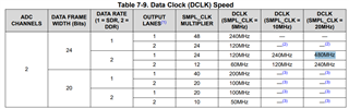

I'm trying to configure the ADS9229 to work in 24-bit, DDR, without averaging, 1-lane output mode. As Table 7-9 suggests, this configuration is possible. Now I'm able to write to the configuration registers via SPI and read the correct values back. I'm also able to write to the test pattern register and observe the changes in DOUT, which indicates the SPI communication is working properly. However, the DCLK output frequency always remains at 240MHz.

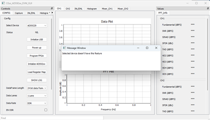

Meanwhile, I also saw your GUI tool for configuring the EVM. When I set the configurations there, it says the selected device doesn't have this feature. Please clarify this.
    Regarding this, yes, 24-bit, DDR, 1-Lane, is possible, but it is only supported when averaging is enabled. Below Table 7-9, in the footnotes it notes that this mode is only supported when data averaging is enabled.  The "(2)" in those rows seems to be missing which I will note so it is updated on the datasheet. Thank you for bringing it to our attention.
    Table 7-8 suggests the DATA_LANES should be set to 2 for my configuration. However, Figure 8-18 says this register should be set to 7, and all the CLK settings should be changed accordingly
    Thank you for bringing this to our attention as well, we will make this change on our datasheets. the correct value for "DATA_LANES 0x12[2:0]" should be "7" on the rows that have "1" on the "Output Lanes" column.
    Regarding to the 240MHz you were seeing when configuring the device per Table 7-8, it would remain in 2-Lane mode and according to Table 7-9 and equation 4, this would make DCLK = 240MHz. if DATA_LANES,CLK1, CLK2, CLK3 & CLK5 are configured according to the descriptions in the register map then 480MHz should be attainable.
    That being said, we do recommend that if 24-bit, DDR, 1-Lane is used averaging should also enabled, since it is not supported without it.
    The mode not being supported without averaging is also the reason why it is locked on the EVM GUI, to avoid configuring outside recommended modes.

    When comparing Table 7-8, lines 7 (or 5) with the register definition, an inconsistency is found in the parameters CLK1 and CLK3. Table 7-8 recommends CLK1,CLK3=0, while the register map says CLK1,CLK3 =1. If I understand your last reply correctly, the table configuration of the line 7 leads to setting DCLK=240M, while following the register-map configuration leads to DCLK=480M. I also understand that TI does not support 480M 1-lane DDR, but it could theoretically work.
    Ideally yes, following the register map, Table 7-9, and leaving the OSR enable for the end, 480MHz should be attainable on the DCLK, but to ensure the best performance for this device, actual 480MHz on DCLK was not made available when in DDR mode.  For this I would suggest following Table 7-4 (assuming OSR 4) then setting CLK5 (Table 7-8) .
