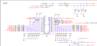

Dear team,
Could you help to review customer ADS7961-Q1 sch?
Thank you.
Charles

Hi Charles,
How fast will the device be sampling at? 47nF at each input seems excessive, and my concern is that the input signal won't settle fully to full resolution of the ADC. This is an 8-bit device, so it is very forgiving, but it would be good to verify. 4.7nF should be big enough to quickly replenish charge to the sampling capacitor.
1kohm input filter resistors also serve to prolong the input signal settling time. If you share the sampling speed I can analyze it quickly and suggest alternative values.
Joel
Hi Meraz
Thank you for your reply;
Please help to check the connectivity of each pin of the chip. Because now the sampling rate of each channel may not be the same, we are not sure yet, but we can achieve this by adjusting the BOM,thanks.
