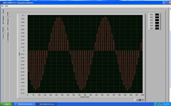

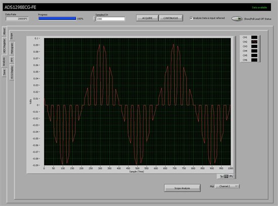

I am feeding to the channel 2, a sine wave with frequency of 5Hz. When I read back from the board, everything is OK, except that the sine wave is multiplied by a square wave with a frequency of around 1KHz.
Why is this happening?

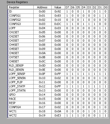

    Welcome to the forum!  Can you tell us how you have the power to the ADS1298 set up (bipolar +/-2.5V supplies or 0-3V)?  Could you also grab a screen shot of the ADS1298 register tab so we can review how you have the device configured?
  • I haven't changed anything much from the defaults. I have attached a screen shot of the board to look at the jumper locations and also the register map. For power supply, I have just used the DC-adapter that came with the board and I connected that to the mother board.

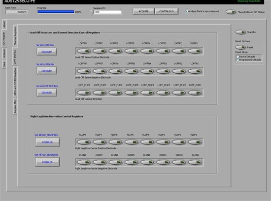

    Looks like from your register settings that you are running the converter at a data rate of 4kSPS and seeing a 1KHz signal on top. Could you go in and turn off all of the lead off bits and double check that you do not have AC lead off enabled? The AC leadoff excitation signal would show at 1KHz if enabled. Your register settings look like you do not have it enabled but I figured I would bring it up just in case.

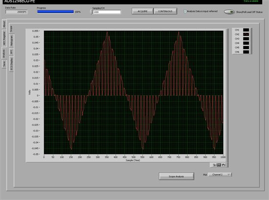

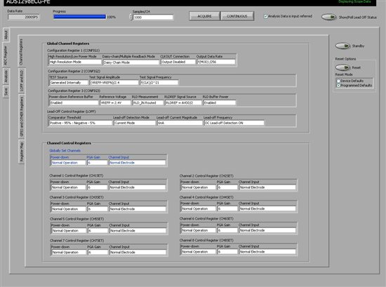

  • I am sorry, I miscalculated the frequency, if you see from the waveform, the square on top of my signals has a frequency of around 100Hz. I have turned all of those bits and also have attached the screen shot of my settings + what I get when I feed it a ramp with frequency of 5Hz while sampling at 2000SPS
    I still don't know what is going wrong!
  • I missed the screen shot of lead-off page:

    Relative to TP1, the reference (TP3) should read about -0.1V if you have the internal reference configured for 2.4V (your CONFIG3 at 0xDC implies this is how you have the reference set).  The reference is relative to the AVss supply, so when you measure from ground (TP1) you should see -2.5 + 2.4 = -0.1V.  With the reference set for 4V, relative to TP1 you should see -2.5 + 4.0 = 1.5V.  If the reference buffer is powered down, or if you just powered up the board without loading the software, you would see -2.5V at TP3.

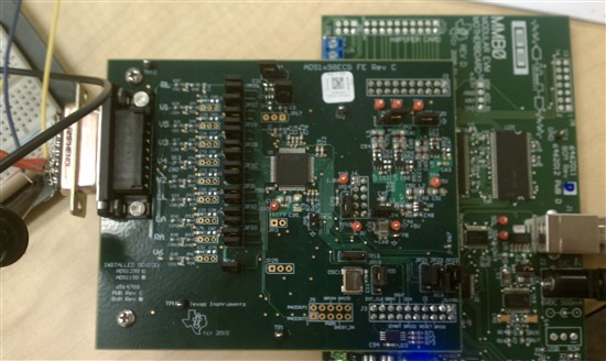

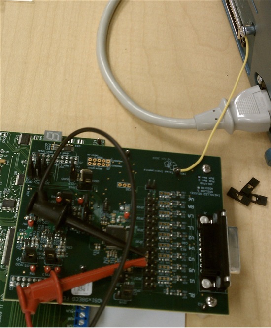

    I did as you suggested; however, I got the same type of error. I looked at the FFT page and I noticed huge spikes at all the 60Hz harmonics. What I did next was connecting the ground of signal generator directly to the ground of the board (the picture). The connection completely removed the interference and the signal became crystal clear.
    I don't know why this connection rejected the huge power supply interference which looked light short circuit, do you know? Anyhow, I want to measure the electric potential between the right hand left hand (lead I) and it seems to be impossible to do it with just two cables as I have hoped. The signal is just  lost in noise and interference. Do you think having right leg drive would be the only way to do it?

    I'm happy to hear you found the problem!  We've been using various Stanford Research and Agilent signal generators to test the boards and I've never seen this sort of behavior from that equipment.  Using batteries definitly helps reduce 50/60Hz pickup from the power line, but you can still get pickup from everything else around you - lights, equipment, etc.  The RLD helps as does good shielding of the cables.
