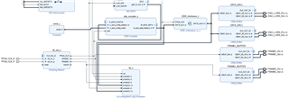

I am configuring a system consisting a FPGA board (Avnet Microzed 7020), connected to a custom board consisting 2 DAC3484 and a CDCE62005.
My initial goal is to understand the utilization of a single DAC, and I am trying to receive an output (measured by my scope) of a 5MHz sine wave given by my NCO (+the phase of the DDS).
the FPGA board is configured to output a 16-bit data signal in sign-and-magnitude representation, where rising edge shows the sine wave phase, and falling edge shows the cosine wave phase as the output.

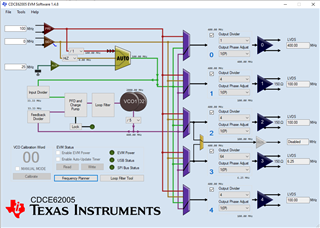

my CDCE62005 configuration (connected to a primary clock of 100MHz):
    0xEB40032, // Register 0- DACCLK1 400MHz
    0xEB84030, // Register 1- DACCLK2 100MHz (currently irrelevant because I am concentrating on DAC1)
    0xEB84030, // Register 2- Irrelevant
    0xEB3C030, // Register 3- -OSTR 6.25 MHz
    0xEB84031, // Register 4- FPGACLK 100 MHz
    0x10080BF, // Register 5
    0x04BE008, // Register 6
    0xBD0037F  // Register 7

additional information about my system:
* F_DATACLK= 100MHz
*Interpolation is 4
* NCO phase word is 0x03333333
* my relevant part of my FPGA system looks like this:
* My DAC configuration:

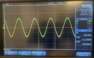

*After setting and resetting the cdce, I get a steady sine wave of 4.27MHz, regardless of the DDS output from the FPGA. for some reason I can not add more pictures to my post so I can not show it.

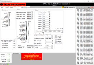

    Would you be able to download the DAC3482 GUI, and convert your settings into the DAC GUI panels for me to review? You can load the configurations in the DAC3482 GUI, and take snippets.
    You can "drag and drop" your pictures to the E2E forum.

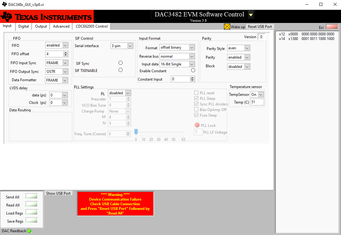

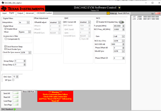

    You may also enable SIFDAC (SPI based DAC) input to bypass your LVDS data and inject our own DAC internal DC data. This can help you check if you have the right NCO setup on the DAC3484. You can enable SIF_DAC, change to offset binary, and make sure the SIF_DAC is set to 0s (for most negative binary weight)
  • Hello Kang, thank you again.

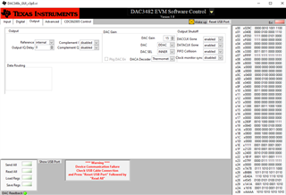

    I tried using the SIF_DAC interface as you suggested, but got the same results. Here are the screenshots from the GUI:
    I know that the input is considered as offset binary, I configured my DDS to sign and magnitude mode.
