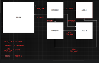

I am trying to phase synchronize the outputs of two ADC12DJ3200 IC's.
I configured the ADC12DJ3200 to JMODE-6 (8-bit, 4-lanes, dual channel) by setting the following parameters-
Sampling Frequency = 2 GHz
ADC dev_clk = 2 GHz
line rate = 10 Gsps
JESD ref_clk = 250 MHz
SYSREF Frequency = 3.125 MHz
I have set K = 32 and RBD = 28. I am generating the JESD_ref_clk and sysref from LMK0482 and the ADC clocks from LMX2594. The clocks to both the ADCs are fed from LMX2594 and the sysref
to both the ADCs is fed from LMK0482. The clocks are monitored in the scope for different power cycles and observed to be synchronized.
The ADCs are fed with 900 MHz input signal. When the ADC outputs are plotted, it is observed that the channel outputs within the ADC are synchronized and the outputs between the ADCs are not synchronized.
I tried the SYSREF POSITION DETECTION method for synchronization. The sysref position capture values of two ADCs are different and the values of one of the ADCs is varying from run to run.

  • Hi Anirudh,
    Please send over a block diagram of your two ADC setup.
    This will be more clear to us on what you are implementing.
    Rob

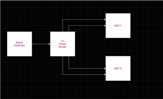

  • Hi Rob,
    The attached image is the block diagram of my setup.
    Anirudh
  • Thank you Anirudh,
    Are both the sysref and clock lines length matched respectively?
    Rob
  • Yeah Rob,
    Both the sysref and clock lines are length matched and the clocks are also synchronized from power cycle to power cycle.
    Anirudh
  • Hi Anirudh,
    In re-reading your post closer, I believe you are referring to the signal phase captured or analog phase.
    Keep in mind the sysref will not synchronize the analog phase. All sysref does is synchronize the digital outputs.
    If you want to do a fine analog sync then you can use the devices TAD adjust features and correct for this analog phase offset.
    If you are see differing phase across channels over power cycles then the link is not correctly configured for deterministic latency.
    If this is the case, then please check reg 208, the JESD status register on the ADC this will let you know if sysref is getting captured correctly.
    If this all looks good then it could be an FPGA issue.
    Rob
    PS - I assume your block diagram refers to your board design. Where everything is on one board? Or is this implementation being done with two of our EVMs and an FPGA dev kit?
  • Hi Rob,
    I am checking the phase difference between the digital output samples of the two ADCs. The value in the JESD status register (0x208) is 0x64, which indicates that the JESD link is up.
    Yes Rob, the block diagram refers to my board design and everything is on one board.
    Is there anything else that need to be done for the phase synchronization between the ADCs?
    Anirudh
  • Hi Anirudh,
    If you are tryin to phase synch the two analog input signals, then we need to look at the frontend, cables, etc.
    Please provide details on this setup. See below...
    Rob
  • Hi Rob,
    I am giving input to the ADC through a 1:4 power divider. The analog outputs from the power divider are monitored in the scope and observed to be in sync. Also the inputs to the ADC are fed from the length matched cables. I have attached the block diagram depicting my setup for the reference.
    Can you confirm whether the ADC registers that I have been writing are correct and are there any registers that have to be written to attain synchronization?
    Anirudh
  • HI Anirudh,
    Unfortunately, the 1:4 power splitter and length matched cables are not enough.
    Need to have phase matched cables, length matched does not equal phase matched.
    Also, you probably want to measure the phase mismatch from the 1:4 splitter using a VNA.
    One or both is the source of the mismatch error.
    Rob
