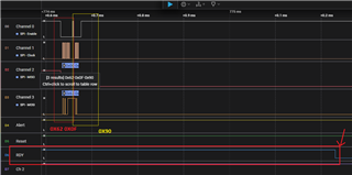

  • HI ,
    Thanks for the response.

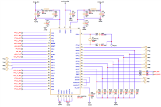

    I am using the Eval board of ADS1158,Please find the https://mm.digikey.com/Volume0/opasdata/d220001/medias/docus/2208/ADS1158EVM_1258EVM_-PDK_Gde.pdf (Eval board Please follow Page 37), rest all configuration as mentioned above, since It has so many jumper configuration, above I have explained the connection, if any thing more kindly let me know.
    Also kindly find the code, which is mainly consist of Configuration of Registry and the Reading of ADC, in which I have doubt on my Registry configuration and the Reading of the ADC Channels which seems to be incorrect.

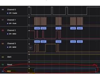

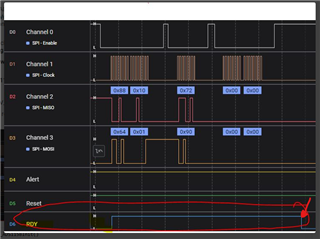

    Also kindly find the attached waveform of the Command and response.(I have connected 1.6V to ADC Channel 0), always get the read response of 0.
    Read Command  0x64 // 0b01100100  (011 - Registry Write Command)  (0 - No multiple registry)  ( 0100- Registry 4 Selected)
    Channel Selction - 0x01
    Followed By 0x90, //DAQ_DRV_OPCODE_PULSE_CONVERT| DAQ_DRV_OPCODE_MUL_MASK;
    Followed by Dummy bytes to read the registry 0x00,0x00 to ready 2 bytes of data

  • Hi Bryan,
    Thank you very much for your time and your suggestion, I am elaborating my steps and observation of my procedure, kindly guide me to resolve it, I appreciate your valuable suggestion.
    As suggested by you I made the reading after the Ready pin transits from low to High.
    Same is the wave form for the reference.
    I feel the read value is not correct.
    Below are the hardware and the Software configuration.
    To highlight few here
    1. Configuration of registry as below, same is read back and confirmed for the configuration is successful(Read Registry code is not shared here,, but tried with with no configuration, read default values, hence confirmed configuration is successful).
    Applied to A0 Pin to  1.661vDC
    ADC @A0 Channel Read Value 760 (In Decimal)
    Applied Gnd to A1 Pin Grounded

    2. Connections are as per the below schematic except Reference voltage not connected(left floating, since using Internal voltage reference for ADC)
    However using Eval board, but connection is as shown here
    Command Sent For Data Ready
    Data read after ready Signal Low To High

  • Hi Bharadwaj M N,
    To clarify, the ADS1158 does not have an internal voltage reference that can be used for conversion data. The ADC uses the reference voltage between VREFP and VREFN, as shown in the datasheet
    The "internal voltage reference" that is shown in some of the block diagrams is literally only used for some internal functions within the ADC. It cannot be used as a reference for the ADC itself however, so you will need to reconnect your 4.096V reference to the VREFP before you can get good data.

    static void daq_drv_ADS1158Init()
        uint8_t l_ucRegDataArray[10];
        l_ucRegDataArray[DAQ_DRV_REG_ADDR_CONFIG0]   =   0b00100000;//Fixed ChannelMode
        l_ucRegDataArray[DAQ_DRV_REG_ADDR_CONFIG1]   =   0;
        l_ucRegDataArray[DAQ_DRV_REG_ADDR_MUXSCH]    =   0;//DAQ_DRV_MUXSCH_DEFAULT;
        l_ucRegDataArray[DAQ_DRV_REG_ADDR_MUXDIF]    =   0;;
        l_ucRegDataArray[DAQ_DRV_REG_ADDR_MUXSG0]    =   0;//DAQ_DRV_MUXSG0_DEFAULT;
        l_ucRegDataArray[DAQ_DRV_REG_ADDR_MUXSG1]    =   0x00;//DAQ_DRV_MUXSG1_DEFAULT;
        l_ucRegDataArray[DAQ_DRV_REG_ADDR_SYSRED]    =   0x00;//Internal Refremce
       daq_drv_WriteMultipleRegisters(0, 7,l_ucRegDataArray);
    //Read ADC Data
    static int32_t daq_drv_AdcRead_(uint8_t l_ucAdcChId, uint8_t l_ucTimeoutVal)
        uint8_t l_ucRdyStatus = 0;
        unsigned long runningms;
        static uint8_t s_ucRegistrySwitched;
        uint8_t l_ucRegisterMap[8];
        //Select Channel
        if(l_ucAdcChId < 8)
          if( s_ucRegistrySwitched )
            // Clear the DAQ_DRV_REG_ADDR_MUXSG1
            s_ucDataTx[0] = DAQ_DRV_OPCODE_WREG | (DAQ_DRV_REG_ADDR_MUXSG1 & DAQ_DRV_OPCODE_A_MASK);
            s_ucDataTx[1] =  0;//Clear the Previous Selection of Registry
            /* Initiate transfer */
            daq_drv_SpiTxRx(DAQ_DRV_SPI_ADS1158_DEVICE_IDX,s_ucDataTx,s_ucDataRx,2);
            s_ucRegistrySwitched = 0;
          s_ucDataTx[0] = DAQ_DRV_OPCODE_WREG | (DAQ_DRV_REG_ADDR_MUXSG0 & DAQ_DRV_OPCODE_A_MASK);
          s_ucDataTx[1] =  (1 << l_ucAdcChId) ;
        else
          if( s_ucRegistrySwitched == 0 )
            // Clear the DAQ_DRV_REG_ADDR_MUXSG0
            s_ucRegistrySwitched = 1;
          s_ucDataTx[1] =  ( 1 << (l_ucAdcChId % 8) );
        vTaskDelay(1);
        s_ucDataTx[0] = DAQ_DRV_OPCODE_PULSE_CONVERT| DAQ_DRV_OPCODE_MUL_MASK;
        daq_drv_SpiTxRx(DAQ_DRV_SPI_ADS1158_DEVICE_IDX,s_ucDataTx,s_ucDataTx,1);
        runningms = xTaskGetTickCount();
        l_ucRdyStatus=daq_drv_GPIOGet(s_stGPIOMappings,0);//Check ADC_DRDY_PIN
        while( l_ucRdyStatus )
          if( (runningms + l_ucTimeoutVal) < xTaskGetTickCount() )
            return ADC_ERROR;//Error state
        vTaskDelay(12);
        // Dummy bytes for reading the Data
        s_ucDataTx[0] = 0;
        s_ucDataTx[1] = 0;
        printf("\nA[%d]:%d ",l_ucAdcChId,((s_ucDataRx[0] << 8) | s_ucDataRx[1]) ) ;
        return ((s_ucDataRx[0] << 8) | s_ucDataRx[1]);

  • Hi Bharadwaj M N,
    As I mentioned in my previous post, you are not converting the codes to voltage correctly
    The values you are seeing are approximately correct, so I don't really understand what your issue is. And you copying your same reply does not help
    -Bryan
  • Hi Bryan,
    Thank you very much for the reply.
    I got it what you are saying. But I am having another issue
    1. I have provided 3.3V of Reference voltage for the VREFP(Earlier i had given 4.096,As in the above shared Schematic, rest all connections as is).
    I have enabled Austo Scan Mode, hence while reading the data first byte I would get Status byte followed by ADC values MSB and LSB.
    When I apply Gnd to A0 Channel I am getting 0xFF44(which I understand its correct as per Document Table 7, as explained above by you) which is correct.
    When I apply ~0.8V(Read in the Multimeter) to Channel A0 it reads 0x1D01 which is Equivalent of ( (3.3 /* My Reference Voltage*/  / 65535 /*ADC 16 Bit value*/  * 0x1D01  ) which is equivalent to 0.37388V ADC Read value is incorrect here.(I measure the VREFP with the Multimeter, which is 3.3Vcorrect).
    I am unable to understand why the values are not correct, which is almost half of what is applied.
        l_ucRegDataArray[DAQ_DRV_REG_ADDR_CONFIG0]   =   0b00000010;//auto with status
        l_ucRegDataArray[DAQ_DRV_REG_ADDR_CONFIG1]   =   0x03;//DAQ_DRV_CONFIG1_DRATE_125000SPS;//Highest data rate
        l_ucRegDataArray[DAQ_DRV_REG_ADDR_MUXSCH]    =   0x00;//DAQ_DRV_MUXSCH_DEFAULT;
        l_ucRegDataArray[DAQ_DRV_REG_ADDR_MUXSG0]    =   7;Enabled A0,A1,A2 only
    static int32_t daq_drv_AdcRead(uint8_t l_ucAdcChId, uint8_t l_ucTimeoutVal)
        s_ucDataTx[0] = DAQ_DRV_OPCODE_PULSE_CONVERT | DAQ_DRV_OPCODE_MUL_MASK;
        vTaskDelay(1);
        s_ucDataTx[0] = 0;
        s_ucDataTx[1] = 0;
        s_ucDataTx[2] = 0;
        daq_drv_SpiTxRx(DAQ_DRV_SPI_ADS1158_DEVICE_IDX,s_ucDataTx,s_ucDataRx,3);
        uint16_t l_ucVal;
        float l_fVal;
        l_ucVal = ((s_ucDataRx[1] << 8) | s_ucDataRx[2]) & 0Xffff;
        l_ucVal = (l_ucVal & 0X8000)?0:l_ucVal;// To Check if GND Applied
        l_fVal = (((0.0000503547722590981) * l_ucVal) );
        printf("\nA[%d]:%d,%04X , %f",((s_ucDataRx[0] & 0x1f)/* Extract Channel */ - 8/*Since Single Channel subtract by 8 */),l_ucVal ,l_ucVal, l_fVal ) ;
        //printf("\nA[%d]:%d %04X",((s_ucDataRx[0] & 0x1f) - 8),l_ucVal , l_ucVal  ) ;
        return ((s_ucDataRx[1] << 8) | s_ucDataRx[2]);
  • Hi Bharadwaj M N,
    As I mentioned previously, and as shown in the datasheet, the code range extends from -2^15 (negative full-scale, or -FS) to +2^15 (positive full scale, or +FS). This corresponds to a voltage range of -1.0666*VREF to +1.0666*VREF. Therefore, the full-scale range (FSR) = +FS - -FS, or just 2*FS
    The LSB size is FSR / 2^16 because you are using a 16-bit ADC. In this case, LSB = 2 * 1.06666 * 3.3 / 2^16 = 107.42uV
    Your code 1D01h = 7425d. If you multiply the code by the LSB size you get the measured voltage. So 7425 * 107.42uV = 0.797V, which is the input voltage you applied to the ADC. So everything is fine
    -Bryan
