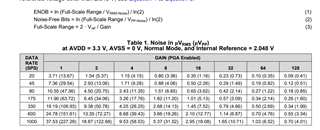

  • What is the effective number of bits (ENOB) we can expect from the ADC with the above said configuration?
  • Hi MANOJ V
    Yes, a single-ended connection will work here, and the ADS1220 is capable of single-ended measurements
    The ADC noise depends on the data rate. The effective resolution will be largest when the input signal is maximized. Use equation 1 from the image below to calculate the effective resolution, but use your input signal (2V) instead of "Full-Scale Range" in the equation. Use the appropriate noise value from the table, which varies as data rate and gain changes.
    This will give you the theoretical maximum effective resolution that your system can achieve
