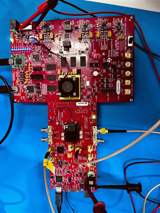

I am following the steps provided in the manual, by providing the DAC clock @ 10.24GHz using SMF 100A signal generator with power level of 10dBm at the connector J6 and reference clock @160MHz @ 12dBm at the connector. I installed all the Apps as suggested. FPGA (TSW14J59) is powered seperately (12V, 3A) setting FMC power to OFF on the board, and DACEVM is powered using another power supply (12V, 3A). I see green lights on the DAC eval board.
After this, I started with GUI DAC39RF12EVM software, followed the steps as suggested J59 server is up and listening on port, I programmed the DAC as suggested in JMode0 as described, What I don't see any output on the spectrum analyzer at 4GHz.
Could someone help me what I am doing wrong, anything to look out for ?

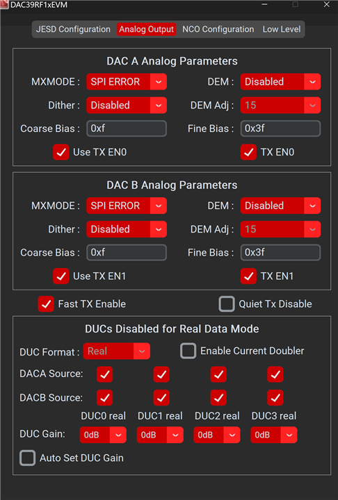

  • Hi Kramer
    I generated the tones on the FPGA using the High speed data converter @4GHz. with the same sampling rate of 10.24G using the Jmode0. I tried refreshing the DAC GUI, it doesn't seem to refresh to know the status.. Also the Analog output tab as SPI error, after changing it and moving to next tab and back. It reverts back to SPI error. I am not sure if it is related or not. Something seems buggy.
    Venu
  • This looks like the SPI isnt working. SPI ERROR is the MXMODE as its likely reading back 0xFF for all registers and therefore the MXMODE it read back is not valid. Can you confirm the SPI is setup properly?
    Matt

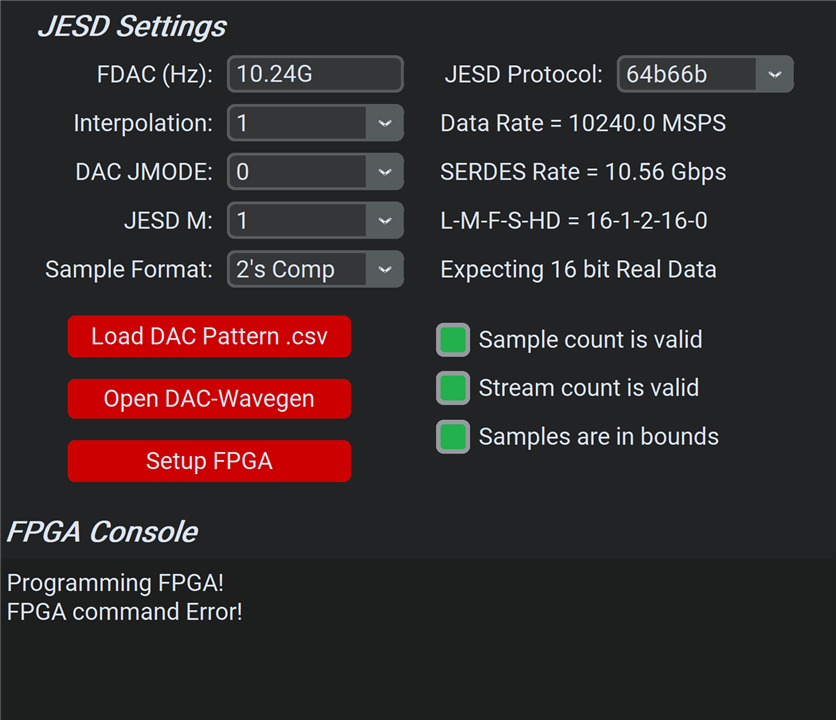

  • Hi Matt
    This issue I rectified, I accidentally disabled the FMC comm. Now this issue is not there. However, now I see more like this. FPGA command Error. What does that mean ?Is the FPGA pre-programmed or should I program it seperately before running this code ?
    VVenu

  • Hi Matt
    Here is the output on J59 server
    It looks I need to program the FPGA.
    Venu
  • It looks like it was able to program the FPGA. Can you confirm the clocks have been setup properly on the DAC EVM as well as the DAC EVM is getting the appropriate reference clock for your configuration?

  • Hi Matt
    Could you please help me out with the error (FPGA command error) ??
    Venu
  • The J59 Commander first checks to see if the firmware is programmed on the FPGA, when it does this that message is printed on the screen. If the firmware is not loaded it then programs the FPGA.
    It seems the FPGA is backing out for some reason. Some error is occurring causing it to back off. let me check with the FPGA firmware engineer to see what is going on.

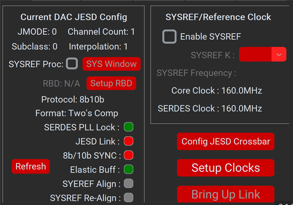

  • Hi Matt
    I uninstalled the DAC39RF12EVM and cleaned up all the files. I reinstalled now as clean DAC39RF12EVM software. Now when I run the same steps.
    FPGA programmed, successfully no error. I still don't see the output.
    The JESD link shows this. I am using the Jmode0 (listed in the EVM)
    JESD link is not up.

  • The DAC appears to be in 8b10b mode (based off the current JESD configuration) and the FPGA is being programmed into 64b66b mode. Make sure both the DAC and FPGA are being put into the same protocol (link layer).
    Matt
  • Just something to add. Make sure you press "Setup Clocks" as well as "Bring up Link" That will load the JESD profile displayed on the GUI into the DAC.
