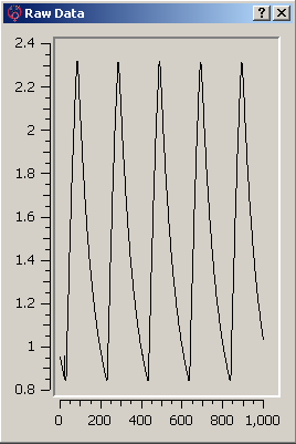

  • Here are a couple images to help describe what I am seeing.
    Image 1:
    This is what the converted signal should look like (except for the 0.5V offset that shouldn't be there).  I get this if I apply the input signal to A+ and connect the A- pin to ground through a cap.
    Now, if I remove the cap and leave the A- pin disconnected the way it works in our ADS8361 design, I get the following converted waveform:
    Image 2:
    Similar periodicity but wrong shape and levels.
    Does this indicate that I need to drive the input(s) differently between the ADS8361 and the ADS8363?  Or is there something else I am missing?
    Joe.
  • Hi Joe,
    The input stage of the ADS8361 versus the ADS8363 is a little different.  In both devices however, we normally recommend that a single ended input be coupled with placing the (-) input pin at the level of the reference (normally +2.5V).  That would allow you to swing the (+) input from 0-5V.  Tie the (-) input to the same 2.5V source that you used for the reference and let me know what you see.
  • With the A- input tied to the 2.5V reference, I am now seeing the signal I am expecting (although it still has the 0.5V offset).
    By slowing things down a bit I determined that the input signal gets corrupted (the 0.5V offset) at the moment that I enable the clock and frame sync from the DSP.  Prior to that, I see a nice clean 0-3V pulse on my scope.  It almost looks like a power or ground problem but, just for comparison, I do not see this behavior when I swap the ADS8361 evm back in.
