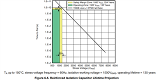

Hi team,
My customer pointed out that the old datasheet for AMC1303M2520 (SBAS771), it shows the Reinforced Isolation Capacitor Lifetime Projection below.
From the graph reading, the lifetime looks like 1e+9 = 31years.
However, operating lifetime is shown as 135 years.
In the latest datasheet (SBAS771D), it looks like corrected.
Was it just mistake on the datasheet?
