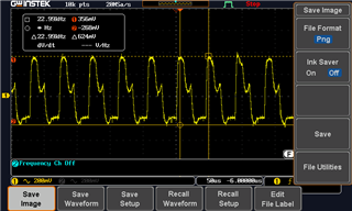

When have connected Constant 3Vpp Input voltage using Function generator to ADC channel CH0, we are getting different values everytime we read 0x02 and 0x03 registers. We have combined both register readings to get 12 bit digital data and converted to voltage format using below formula. Voltage output is varieng between 0.5V to 3V continously.
Volt = (12_bit_data/ 4095) * 3.3; //AVDD connected to 3.3V
But when we remove input at CH0, we are getting constant 0x61 from 0x02 register and variable value from 0x03 register. After implementing the formula the voltage is coming between (1.269v to 1.272v).

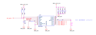

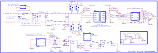

Our Schematics screenshot:

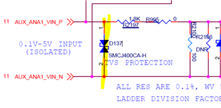

  • Hi Balaji,

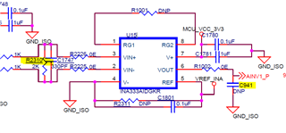

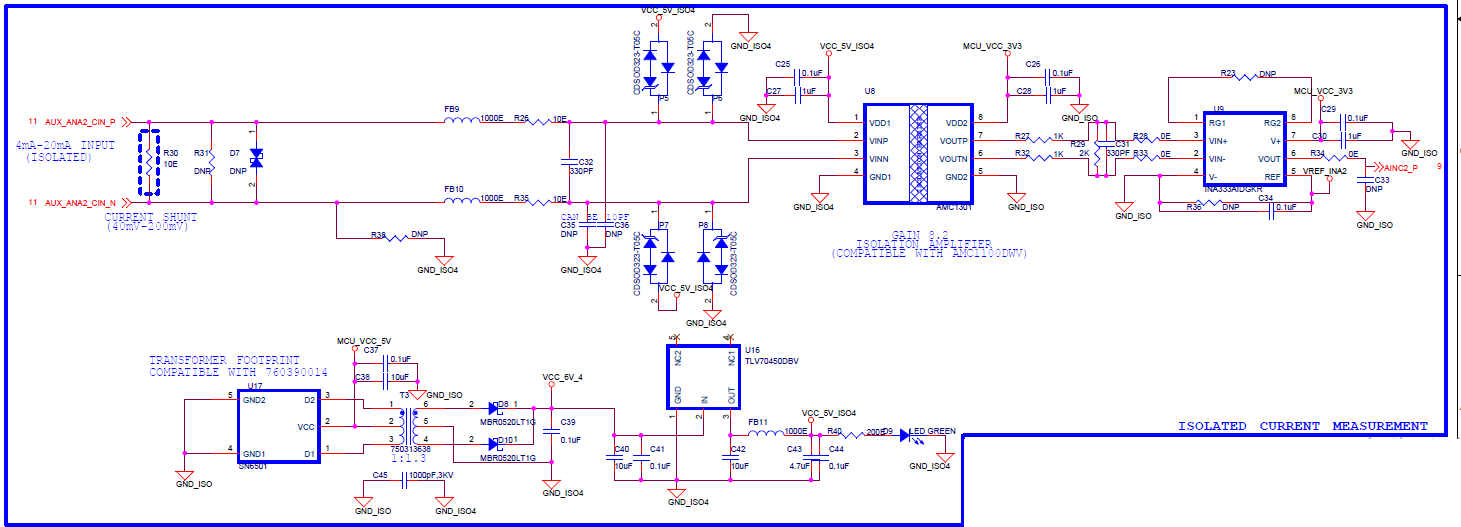

    Please describe what is to the right of the analog inputs.  Do you have a buffer between the ADC input and function generator?
  • Hello Tom,
    Thank You for the quick response.
    We have a Gain Isolation Amplifier Circuit(AMC1301) and a Precision Amplifier (INA333AIDGKR) between ADC input and Function Generator. Currently I don't have full access to schematics. I got above information from our hardware team.
    Is buffer compulsory between ADC input and Function Generator?
    Balaji TS
  • Hi Balaji,
    It depends - there are cases where you can get away without a buffer in front of a SAR converter like the ADS7924.  Can you use an o'scope and verify that the amplifier is not oscillating?  Take a look at this video and see if it helps you resolve the issue: https://www.youtube.com/watch?v=JWmSgP0KQWQ

    The issue we were facing was due to Analog input which we were giving. By mistakenly we gave AC Voltage to ADS7924 input channels. Which caused that issue.
    Now we are giving input using DC Voltage source, now we are able to read proper ADC output but there is around 100mV continous fluctuaions in the readings. I have attached ADC readings which conatins register readings and converted Voltage values for 1V, 2V and 3V input below. Can you please tell us what might be causing the issue?

  • Short your input and see what sort of conversion results you are getting.  Can you include the full schematic for the input stage please?
  • Hello Tom,
    Sorry for the late response. Today we got access to the schemtics of our board. Below I have attached the schematic for the input stage. Please check it once.
    What do you mean short the input? Do we have to short input side positive and negative pins?
    Thank You.
    Balaji TS
  • Short each channel to ground (one at a time, using tweezers for instance) at or as close as you can get to the ADC inputs and check the conversion results.  Then go back through the rest of your analog front end and do the same thing.  Short the output of the INA, then the input - the output of the ISO AMP, etc.  That can help you to locate where the noise is coming from.
  • Hello Tom,

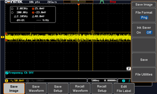

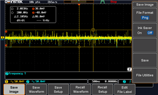

    We have probed at few places in board, we have observed some noice at all the points and below attached the DSO waveform of the same.
    We have probed at the highlighed points in the schematics.
    1. At pads of C941(DNP) - observed 232mV continous dip in the voltage.
    So we are planning to do the following reworks:- i) Mounting C941 with 0.1uF cap to eliminate noise.   ii) Add Bulk decap of 10uF for U15 (INA333).
    2. At R2310 Both pads - observed 86mV noise
    3. At D137 Both pads - observed 48mV noise
    Any suggestions from your end regarding the scope probing or rework?

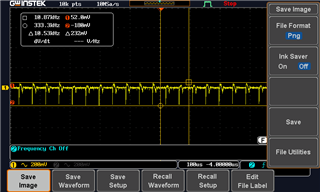

  • Hi Balaji,
    That blip at C91 is probably caused by the charging of the internal sample/hold capacitor.  Can you probe C94 as well?
  • Hello Tom,
    We have probed at C94 capacitor. and we applied analog input 1V while probing at C94.
    Balaji
  • Is that from C941 at the output of the INA or C94 at the ADC MUXOUT pin?  Is this just one channel sampling over and over or is it multiple channels?
  • Hello Tom,
    This probing is at C94 ADC MUXOUT pin. And we are sampling only one channel continously using Auto Single mode.
    Balaji TS
  • You can try reducing the value of R1 and C94. Here is another video that talks about driving the input of a SAR converter.  C94 would typically be 20 to 60X the value of the internal sample/hold capacitor, which is 15pF.  Your 1nF is on the high side.  The other thing you can try is slowing down the throughput of the ADC - basically give the input more time to settle before starting the conversion.  Here is the link: https://www.ti.com/video/5466215483001 this is another good introduction: https://www.ti.com/video/5476574757001

    And also we have current input applied to ADC, where we will be providing 4mA to 20mA. In this convertion the LSB bits are varieing a lot, after calculating the current we are observing upto 0.1mA variations. Below is the schematic for current input stage.
    AINC1_P is connected CH_2 of ADC module. Is there any issue in our schematic, why is the current readings are varieing so much?
