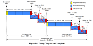

Dear Specialists,
My customer is considering ADS124S08 and has a question.
I would be grateful if you could advise?
If I connect two PT100s (three-wire type) to the ADS124S08, what is the total conversion time for both channels?
I haven't decided whether to use the Low-Latency Filter or the Sinc3Filter.
Is it possible to think of this as a value that doubles the FIRST DATA CONVERSION in SINGLE-SHOT CONVERSION MODE, since I will be switching between channels?
I appreciate your great help in advance.
