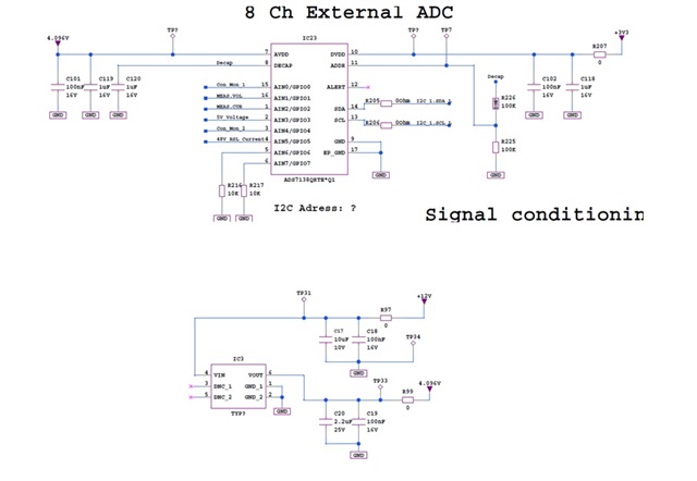

i am using (LT1790 max 5mA) for 4.096 reference of ADS7138. Since i also had INA2191 suitable for this line, i have added it on 4.096 reference.
I am little concerned if ADS7138 and INA2191A1 combined can load LT1790 eventhough datasheet electrical data says less than 1mA together.
Do you think the attached circuit is fine?
for digital lines i have used 3v3 supply as both AVDD and DVDD are independent.
  • Hi Deepak,
    Apologies for the late response on this.
    From the perspective of the ADC, it should be the least concern. As at a maximum, it will draw less than 300uA . The current from the amplifier is a little bit more unknown to me.
    I'll transfer the thread over to the amplifiers team to provide a little bit more detail on the max current you might expect. What exactly is the output circuit that the amplifier is driving, and what is the maximum output voltage swing you would expect?
    Joel
    From the perspective of INA2191, it is OK too.
    Guang
