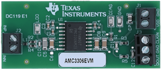

AMC3306EVM comes with AMC3306M25 Sigma Delta Modulators installed so, signal input range is ± 250 mV.
I replaced the AMC3306M25 with AMC3306M05 (± 50 mV; input signal range)
3306EVM
Using a 3 channel arbitrary waveform generator to input sinusoidal signal into INP and INN ports of J2 on 3306EVM.

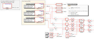

Below is part of simulink model using LaunchXL_F28379D as target
  • Using F28379D for Sigma Delta Filters
  • Using F28379D ePWM for Sigma Delta Clk
    • clk to Sigma Delta Modulator (AMC3306EVM)
    • clk to Sigma Delta Filters (F28379D)
FIGURE 1 - Simulink Model deployed to F28379D

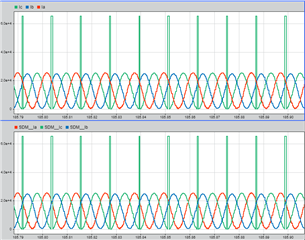

To see full (rail to rail) waveform out of Sigma Delta Filters:
  • Set Input (signal source) DC Offset to +27 mV
  • Set input (signal source) Amplitude to approx 63 mV pk to pk (approx ± 31 mV ref +27mV dc offset)
  • With these settings below is image of what I see on output of Sigma Delta Outputs
    • apologize for the small hard to see image
      • Top set of waveforms are being measured towards the end of the model shown in FIGURE 1.
        • Signal is centered about a count of 16384
        • high side pk is very close to 32768
        • low side pk is very close to 0
      • Bottom set of waveforms is directly out of MCU SD Filters
        • Identical to the waveforms described above.
Questions / comments:
Am using Sin3 filter setting on the MCU SD Filters (Filter has option for 16bit or 32 bit representation); 3306M05 datasheet says 16 bits of resolution can be achieved. (2^16 = 65635; 2^15 = 32768)
  • Did not see difference in SD Filter output range related to filter resolution option; 16 or 32 bit
From what I am seeing.. max signal I can get out of SD Filter is 0 to 32768)  why?
Should it be 0 to 65635 or is msb supposed to be an indicator of positive / negative excursion
My signal into the SD modulator is approx 60 mV pk pk.. with a 27 mV dc offset; This is a signal of ± 30 mV pk, right?  Should it not be at least ± 50 mV?
Lowering my input signal amplitude to approx 50 mV pk to pk (± 25 mV) then lowering DC offset to approx 22 mV I get the following waveforms:
Again sorry for the hard to see image: (again top and bottom plots are practically identical
  • Bottom set of waveforms are being measured at output of SD Filter blocks shown FIGURE 1.
    • since DC offset was lowered so was the center point of waveforms
    • low side pk... green waveform is just starting to touch a zero count; then looks like it wraps up a max count of 65635.
What am I missing?
Is it how I am driving Modulator?
Are these output waveforms correct?
Am I using the MCU Filters correctly?

    I believe the main reason you are only getting from 0 to 32768 is due to you never going below zero except in your second example. 0 to 32768 represents positive values when 32769 to 65635 represent negative.
    However, I am concerned that you are getting max values for your first set up, this would imply that the SD is measuring maximum voltage (higher than +- 50 mV). Is this due to how you set up your SDFM?
    Looking at the second waveform, this looks more correct as you are driving the modulator at 50% of its capabilities thus the 50 of the effective range is used. The main reason for the values that dip below 0 going to 65635 is negative

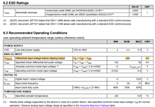

    Looking at the datasheet for the AMC3306M05, it is saying Diff input voltage before clipping is  ± 64 mV nominal;  The specified linear diff full scale is      the ± 50 mV
    So my signal was approx 60 mV pk to pk (maybe @ 63 mV pkpk clipping occurred) or ± 30 mV with dc offset of approx 27 mV.

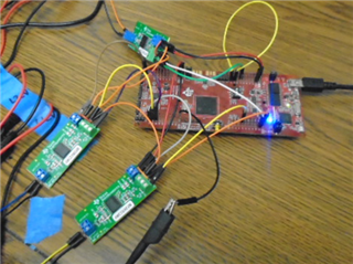

    Here is more information about my set up:
    • 3 Sigma Delta Modulators eval boards(3306EVM) replaced 3306M25's (± 250 mV) with 3306M05 (± 50 mV)
      • DC supply to Modulators is +3.3V; supplied from LAUNCHXL_F28379D
      • SD_clk is provided by one of the LAUNCHXL_F28379D's ePWM blocks running at approx 20 MHz
    • 1 LAUNCHXL_F28379D (C2000 Delfino; sysclk = 200 MHz; 4 core floating point MCU (CPU_1, CLA_1, CPU_2, CLA_2)
      • SD_clk for SDFM (SD_Filters in MCU) is also supplied by same ePWM block running at approx 20 MHz
    Input into the 3306EVM's is provided by 3 ch Arbitrary Waveform generator. (signal source)

    The AMC3306M05 can handle up +-64mV but this is not recommended as more than 50mV the response of the device becomes non-linear. Thus, it is recommended to stay in the 50mV range.

  • Issue Resolved.  It was a data type issue.
    Data type out of Simulink SDFM block was uintXX, could be uint16 or uint32 based on "Data representation:" of block settings in SDFM block parameters in Simulink.
    Adding a data conversion, like intXX, corrected the issue.
