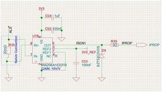

Hi, we would like to use ADS8355 to sample two legs of low side current of a H bridge, The current sensing are using INA296B (we will also evaluate using OPA2863 to build a low side current sense circuit) and a shunt resistor, can we connect the output pins of INA296 directly to ADS8355 via a RC network without any driver amplifier?
For OPA2963, the schematic is like TIDA-060019A
and for INA296, the schematic is like follows,
The question is that can we directly connect ISEN or AVout to ADS8355 via an RC without any driver amplifier to minimize BOM.
BTW, what is the criterion of adding ADC driver amplifier? the output impedance?

    For the ADS8355 at full sampling speed (1MSPS), yes, you do need an ADC driver for the INA296 current sense circuit. The low side current measurement with the OPA2863, could be able to drive the ADC directly without an additional driver, if the RC is adjusted accordingly.
    Do you plan to use the ADS9355 at 1MSPS? if the sampling speed is slowed down and/or some error is permitted the INA296 would be able to directly drive the ADC with an RC.

  • Thank you, I plan to use INA296 + ADS8355 for dual leg (a H bridge) current sensing. The speed are required to run at 1MSPS and possibly more higher, the resolution can be lower to minimal 12bits. We also consider ADS7853 for a low cost option.
    Why INA296 cannot be connect directly to ADS8355 when the sampling frequency is 1MSPS? I calculate the RC filter to be 4.7Ohm and 22nF, and sampled at 1MSPS, is it OK to do so?

    Ideally yes, but the INAs don't typically have the bandwidth to drive precision ADC, which is why when using an INA it is recommended to incorporate an additional stage that would be able to drive the ADC or to slow sampling rate down to a point where the INA would be able to drive the input.

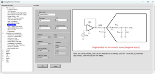

    To drive the ADC the source should be able to drive the switched capacitor load of the ADC and settle within 1/2 of an LSB within the acquisition time (for the ADS8355 this is 350ns; please also note that it should not just be settled by the 350ns, but a bit before to allow accurate measurement of the settled signal). The RC filter at the input of the ADC is also incorporated as a charge kick back filter to help allow the ADC's  switched capacitor to charge and settle within the acquisition time (as well as help with aliasing).
    Typically the bandwidth needed to drive an ADC is at least 10x the sampling frequency for lower resolution ADCs, but it could be even higher depending on acquisition time, resolution, and range. With the INA296 having only a 1.1MHz bandwidth, it would not be able to drive the ADS8355 directly without slowing the sampling down or aiming for lower resolution measurements.
    Other things to consider beyond the bandwidth of the INA is the driving capability. It should not just have the bandwidth and slew rate capability to settle the signal, but also charge the RC filter + the switched capacitor load of the ADC. I couldn't find current output for the INA296 in the datasheet, but it does have a maximum capacitive load of 1nF, making your suggested RC too large to drive. Typically we recommend using 10-20x the sample and hold capacitor of the ADC as the capacitor value of the input RC (for the ADS8355, this is 40pF) so 400-800pF would be drivable, but the INA would probably take >1us for the signal to settle. Lowering the sample speed <500kHz might make it a possible option though.

    I would also recommend looking into our Analog Engineer's Calculator, which is also helpful at designing these circuits for not just data converters but for amplifiers and more. TI Precision Labs also have a lot of information:
