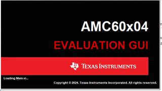

Hi, I am trying to use AMC60704EVM with GUI, however the GUI do not launch, it get stuck at the launching main.vi
Please let me know what is missing that GUI not launching.

Hi Vignesh,
There's the possibility that the Interface Settings popup has appears off your screen somewhere. This popup will keep the GUI from opening until it is finished. See if you can find it through CNTR+ALT+TAB or other means.
