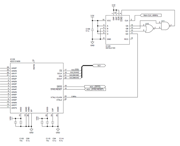

  • Hi Dale,
    The customer considered a circuit based on your suggestion, and has additional questions.
    Could you please advise?
    ---Questions
    1. The sampling rate of the A/D converter built into the microcontroller is 1953.125 SPS.
    I believe the same sampling rate can be achieved by setting the ADS131M08's MASTER CLOCK to 8MHz (fMOD=4MHz) and OSR to 2048.
    Is this correct?
    2.
    You mentioned it's recommended to periodically send a pulse from the microcontroller to the SYNC/RESET pin for synchronization.
    Does this mean that the microcontroller sends a pulse to the ADC at the DRDY timing (i.e., at a cycle of 1/1953.125 or an integer multiple of that)?
    (The datasheet mentions in section 8.5.2 Synchronization that "If the negative edge on SYNC/RESET aligns with the internal data rate clock, the device is determined to be synchronized and therefore no action is taken." I'd like to confirm my interpretation of this sentence.)
    3. The microcontroller's built-in ADC operates based on the timing of the internal 48MHz on-chip oscillator.
    We are considering using a circuit (SN74LV163A) that divides this clock by 6 and supplies it to the ADS131M08.
    In this case, there will be a slight delay in the divider circuit, will this delay be considered "synchronized"

  • Hi Shinichi,
    1. Correct, the expected data rate can be achieved with  8MHz clock and 2048 OSR on ADS131M08.
    2. No need to synchronize in every cycle, they can be synchronized for integer multiple of cycles, it really depends on how long or how much mismatching will be seen in the customer's circuit.
    3. This delay will contribute on the mismatching, but it depends on whether this delay or mismatching is acceptable to the customer. SN74AUP2G80 is used on ADS131M08EVM to divide the 8.192MHz to 4.096MHz and 2.048MHz clock for the ADC on the EVM, see the schematic in the user guide, SN74AUP2G80 has tpd = 4.4 ns maximum at 3.3 V (5.5ns at CL=15pF), SN74LV163A has tpd = 15ns maximum at CL=15pF over temperature. Just for your reference. Please notice the synchronization between ADCs was not considered when SN74AUP2G80 was designed on the EVM.
    BR,
