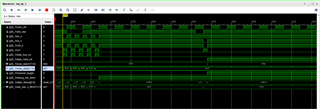

    As per your request  have captured the control lines timings(attached here)
    I can see adc_dav (data_av) is high for 7 + TL (00 in my case).
    After that it goes low for half conv_clk, and output a single value (EE4) after that it remains high indefinitely.
    Where as for the same initialization sequence, when I write CR0 as 020h or 028h, I can see  adc_dav(data_av) line toggling and giving correct output(below snap shot for CR0 as 020h)

    Unfortunately I do not have any FPGA code to share.  Can you bring your /RD strobe half a clock cycle earlier (refer to Figure 30 in the datasheet)?  That should fix things.
  • Hi Tom,

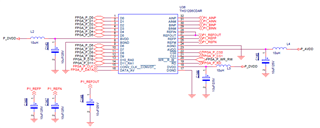

    I did  brought /RD strobe half cycle earlier, still having the same issue, attaching scree grab
    do you suspect any HW connection issue. the HW is connected as below.
  • Can you take a look at Figures 35, 36 and 37 and then using an o'scope see if you are getting a proper read and write signal?
  • Sure Tom,
    I will have a closer look at these figures once again,
    but I have only question, for the same timing condition, if CR0 is 020h or 028h, I am able to get the correct data.
  • For each conversion cycle once the TL has been satisfied, you have to 'read' date to keep DATA_AV active.  You can try bringing in RD another quater cycle so that it is within the same conversion clock period.
