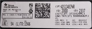

The fascinating part comes now. I also read the FSC register. Our assumption was that each ADC has its own set of GAIN calibration values for the FSC registers. The results for differend LOT numbers were interesting...
We tested with two gain settings of 1 and 2 respective. We did a readout of the FSC register after the gain was changed.
All ADCs with a datecode of 2337 from two different LOTs (3723526ML3 and 3723539ML3) have the same readings for the FSC registers. A gain of 1 gave us a FSC value of 0x400E00, a gain of 2 had a FSC value of 0x400D80. Those values are the same for ALL of the ADCs from the LOTs mentioned above.
To be sure that we didn't made an error, we tested with another LOT with a different datecode which was known as "good" reel. Devices that had an ADC from that reel did never exceed our error limit. The reading of the FSC value were different for each single ADC, as we expected.

Here are the labels of both the reel with ADCs where all have the same gain correction value (datecode 2337) and the reel with the ADCs where each has a separate gain correction (datecode 2251).
Unfortunately I don't have the whole label from the "good" reel at hand, production marked them with an own label as "special". If necessary, we can try to get the other label off and take a new image.
What we now need is an explanation from TI why the ADCs with the given LOT numbers have all the same gain correction values. We checked for a PCN for that device, but nothing was found (also one of our distributors checked for PCNs). We have a lot of ADCs that don't work as promised in the datasheet and we spend a lot of time and effort in researching this issue.
