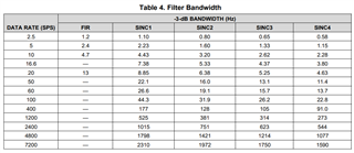

Greetinge Everybody,
I am using ADS1235-EVM. I have connected load cell signal + to AIN0 and signal - to AIN1 and Sense + to REFP0 and Sense - to REFN0. Default value of R in the evm for differential input is 100 Ohms which i have changed to 1000 Ohms. I am giving 5 VDc excitation to load cell. After this setup my Fcdif comes to 9.216 KHz and i am confused about selecting the ODR for the ADC. Any guidance for output data rate (ODR) selection for noise removal will be of great help. My main aim is to remove anti-aliasing as much as possible.
