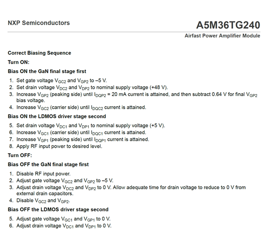

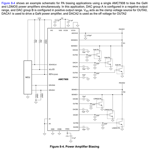

I am looking at the sequencing requirements of the A5M36TG240 and am interested in the TI AMC7908 Bias Controller. If I am understanding correctly, the AMC7908 would be a good bias controller for a single PA with 4 transistors even though 6 transistors are shown in the example. What I am still confused about is how IDQP2 can be untangled from IDQC2 when the two are tied together and measured by a single sense resistor. Do I just apply the current setpoints to IDQ2? Can I infer some split between IDQP2 and IDQC2?
