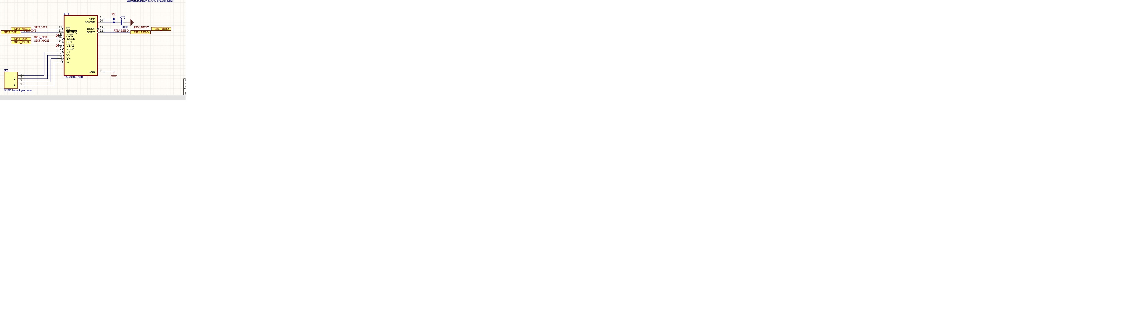

I am getting repeatable, but skewed data across 5" resistive screen.  tsc2046 is setup as 12 bit Differential PD1 =0 PD0 =0
Raw data without touch is 2047, 2047
Average readings from corners
TL = 1175,1950
TR = 1640, 1806
BL = 1180,1606
BR = 1959, 1175
Center 1600,1620
These numbers are repeatable, but why are they skewed?  Is this normal?  How can I calibrate screen?
From code below I wait for PENIRQ line to go low before reading.  Z, X, Y
I tried several screens, same results.
