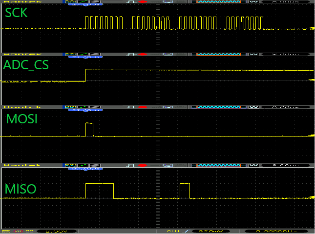

I am currently working on a project using a PIC16F15356 microcontroller and the ADS8689 ADC to read 8-channel 4–20 mA current signals through a MUX, and send the data to a PC via Modbus.
The communication between the MCU and the ADS8689 is implemented using hardware SPI.
At the moment, when I input 4 mA (approximately 1 V), the raw ADC value is around 25,000. However, even when I try to adjust the input voltage range of the ADS8689 using spi_write, the setting does not seem to take effect at all.
I need the full resolution of the ADS8689 for a 0–5 V input range, but currently I'm unable to configure it properly.
I would really appreciate your advice or suggestions on how to resolve this issue.
Thank you for your help.

   output_low(ADS8689_CS);
   for(i = 0; i < 4; i++)
      rx[i] = spi_read(0x00);  // Send dummy 0x00 to receive data
   output_high(ADS8689_CS);
   value  = ((uint32)rx[0] << 24);
   value |= ((uint32)rx[1] << 16);
   value |= ((uint32)rx[2] << 8);
   value |= ((uint32)rx[3]);
   return (uint16)(value >> 8);  // Use only upper 16-bit data
// Write to ADS8689 internal register (32-bit format)
void ADS8689_WriteRegister(uint8 addr, uint16 write_data)
   uint8 tx_buf[4];
   tx_buf[0] = 0xD0 | ((addr & 0x3F) >> 1);  // Command + address MSB
   tx_buf[1] = (addr << 7);                 // Address LSB
   tx_buf[2] = (uint8)(write_data >> 8);    // Data MSB
   tx_buf[3] = (uint8)(write_data & 0xFF);  // Data LSB
   OUTPUT_LOW(ADS8689_CS);
   delay_us(1);
   for (uint8 i = 0; i < 4; i++)
      spi_write(tx_buf[i]);
   delay_us(1);
   OUTPUT_HIGH(ADS8689_CS);

   // 3. Set output format and voltage range
   ADS8689_WriteRegister(0x10, 0x7D08);  // DATAOUT_CTL_REG
   ADS8689_WriteRegister(0x14, 0x000B);  // RANGE_SEL = ±2.5V (5.12V span)
   delay_ms(2);
