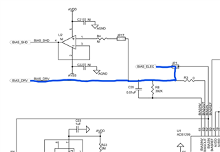

I am working on SPI communication between ADS1299 and nRF52840. I have an ADS1299EEGFE-DK board but I am not using the MMBO board. I established communication between ADS1299 and nRF52840 successfully. I can read and write in the register. When I try to gather signals from the ADS1299, I cannot get any signal. I am using dedicated bias and reference electrodes. I am using internal bias to drive. When I tap the electrodes, I can see the changes in the output, but when I connect the electrodes to the skin, there is no change. The register configuration I used and the hardware configurations are detailed below. Currently, I am working on one channel.

JP25 -> 5th pin BIAS_ELEC
JP25 -> 6th pin REF_ELEC
JP25 -> 1-2 and 3-4 connected
JP1 -> 1-2 connected
JP6 -> 2-3 connected
JP7 -> 1-2 connected
JP8 -> 2-3 connected

  • Hi Omer,
    Can you try configuring the channel to use the internal square wave test signal? This will validate your ADS1299 is operating normally and that your data transmission is correct.
    Please also refer to our ADS129x FAQ page for more suggestions:
    [FAQ] Common Questions for TI's ADS129x Family of Bio-Potential ADCs - Data converters forum - Data converters - TI E2E support forums
    Ryan
