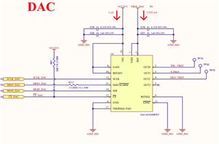

Hello TI team,
We had used 'DAC60504BRTET' in one of our projects, after the board got build we tested them. We had provided 5V from 'REF3450IDBVR' to VDD and VREF pins. While testing we observed that when output of REF3450IDBVR is isolated from DAC then we are getting 5V at the output of 'REF3450IDBVR', but when 5V is provided to VDD and REF pins of DAC then the voltage drops to 2.5V.
I have attached the screenshots of both 'REF3450IDBVR' and 'DAC60504BRTET' from our design. Please advise if DAC consuming more current than the capacity of 'REF3450IDBVR', or we have to make any changes in design for proper working of the DAC and REF circuits.

    We prepared a same circuit on a separate general purpose board and we provided supply to VDD and VREF pins using a separate power supplies, it is observed that supply connected to VDD do not consume much current but the supply connected to VREF pin consumes very high current.
    When the current limit to the supply provided to VREF pin was set to 10mA, it was dropping the voltage from 5V to 2.5V with the supply going into constant current (CC) mode. That is the VREF pin current requirement is exceeding the set current limit.
    When we increase the current limit, it is observed that the VREF pin is consuming more than 50mA current. So such a high current consumption on VREF pin is expected? or the DAC is not changing configuration from internal reference to external reference?
  • Hi Nitesh,
    The DAC internal reference is enabled by default, so this behavior is expected. You need to update the DAC register to disable the internal reference on startup if you plan to use an external reference. I would recommend leaving the REF current limit at 10mA or adding a series current limiting resitor to limit the current in the time between power on and you disabling the internal reference.

    Ideally, shouldn’t the external reference mode be the default for a DAC?
    As a user, if I am applying an external supply on Vref pin then I would consider that default setting of DAC would be on External mode rather Internal mode. Also, until I update the DAC register the internal reference pin i.e. 2.5V and external reference source (5V in my case) would get short and as a result would sink large current, which is visible in our testing with supply connected on Vref pin is consuming 56mA.
  • Hi Nitesh,
    I believe the designers chose the default setting to be this way so the device could power on to a default voltage without the user needing to send any commands or providing external reference. This device has a pretty good internal reference, so they prioritized that function rather than assuming most people would use an external reference. Though I get where you're coming from that it causes some trouble if you do choose an external reference.
    Again, in your case I would recommend leaving the REF current limit at 10mA or adding a series current limiting resistor to limit the current in the time between power on and you disabling the internal reference.
