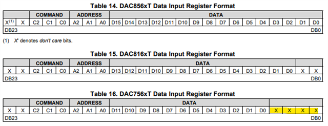

I have the MMB0 operational with ADS1256 ADC but I would like to use the DAC8562TEVM with the same MMB0 card.
What is the SW I need to install to make this combination operational?
Also, I intend to replace the DAC8562T on the eval card with the DAC7562T. Would this require different/additional SW?
Please provide the links to the SW resources - if available
    The following software was developed for the DAC + MMB0:
    DXP Software programming tool | TI.com
    We are no longer are updating this software and some users have had issues with running this is windows 10/11.
    The DAC8562T and DAC7562T have the same command structure. The only difference is the resolution:
    The DAC7562T will truncate the least significant 4 bits if you write 16-bit data to it which is fine. You can se the same software.
