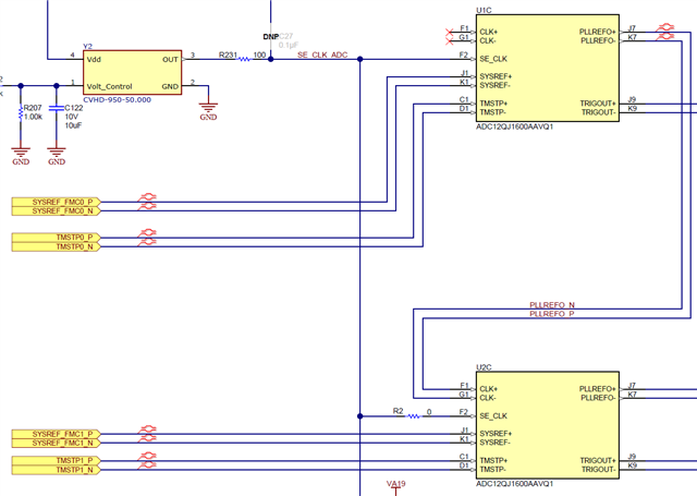

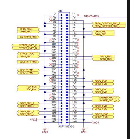

The TSW12QJ1600EVM data sheet provides instructions for using TSW14J58EVM.
The SYSREF +/- of the two ADCs of the TSW12QJ1600EVM are connected to the FMC connector each. (G12, 13, H31, 32 pins)

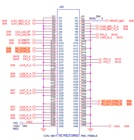

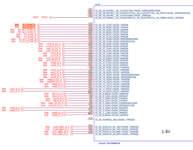

The pins (G12, 13, H31, 32) on the TSW14J58EVM side are directly connected to the FPGA (XCKU5P).
Could your tell me the I/O settings of this?
