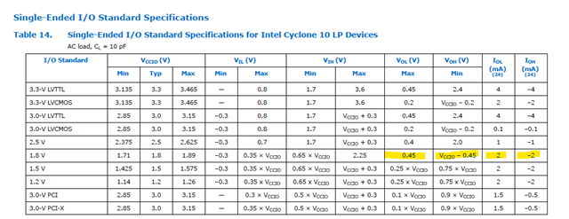

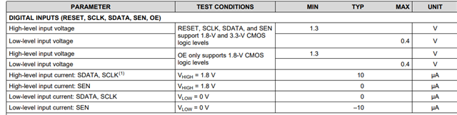

The digital input of the ADC didn't have standard voltage level.
The FPGA VOH/VOL at 1.8V didn't support the ADC VIH/VIL.
How ever, the FPGA level is define in +2/-2 ma current drive.
There are no definition of voltage level at low current, which probably the case in the ADC.
pls. advise how to drive this lines?
should I need dedicated external driver for this task?
