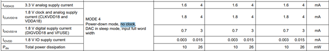

1. How do users configure the power down mode?
2. No clock means users stop inputting the signals to DAC core Clock(DACCLKP/ DACCLKN)?
3. Are there any configurations which is lower power consumption listed in page 14 of the datasheet(MODE 1, MODE 2, MODE 3, MODE4)?

    They put the DAC  into sleep mode and full word width (Configure Address 0x06 appropriately) and turn off the DACCLKP/N.  MODE 4 is the lowest power consumption.

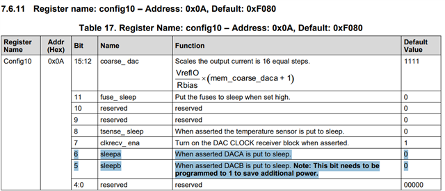

    1. What are sleepa bit and sleepb bit? Do users need to configure these bits to put the device into power-down mode?

    1. For channels A and B of the multi-channel devices

    1.  Do users need to configure these bits to put the device into power-down mode?

    1. Correct
