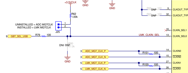

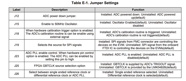

I would like to use ADC's TRIGOUT as GBTCLK in ADC12QJ1600EVM
The schematic says the jumper should be UNINSTALLED while user guide says the jumper should be INSTALLED.
Which is correct?

The EVM schematic is correct please follow this.
