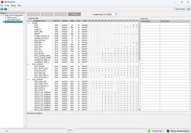

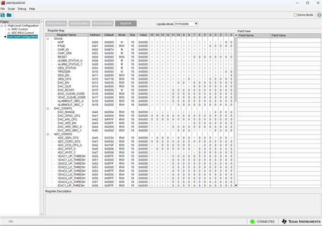

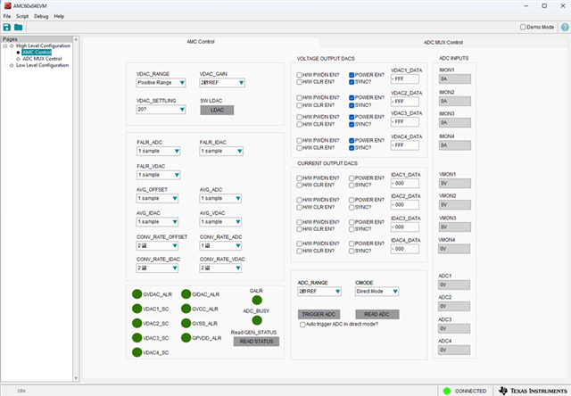

The GUI's screenshots are listed below. It's weird that after I clicking the READ ALL button, all values change to zero, I think the CHIP ID sould be read back at least. But the GUI shows connected (green light), so I think the connection between PC and FT4222 works. I click power_en and sync and set 0xfff for the VDAC output, and click LDAC, the VDAC pins are all measure 0v,  and the Vref pin measured as 0.684v, if I setup anything worng? Please help! Thanks!

    Can you share a picture of the EVM so I can see the jumper settings? It does look like the EVM is not communicating with the GUI at all.
    Usually, I2C returns 0xFF00 when reads are unsuccessful because the SDA line remains high. This could mean there is an issue with the GUI itself. Can you measure the I2C pins on the EVM and make sure the I2C commands are toggling on the SDA and SCL pins when you start a read or write command?

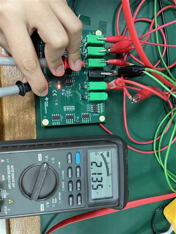

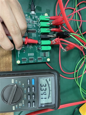

  • The Jumpers remain the default setting
    Belows are every Designator's Voltage
    VIO
    DVDD
    PVDD
    VCC
    I2C's Voltage
    I measured it when I click Read All button
    SCL
    SDA

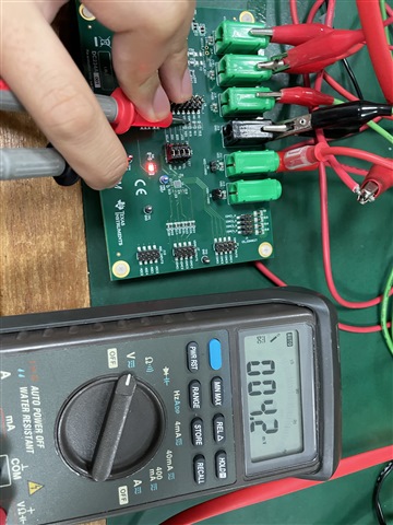

  • Hi Katlynne,
    It seems like the FT4222 lose the connection with GUI? Based on what you said about I2C's pins, I click the read write button but the SDA pin remains 4.2mV

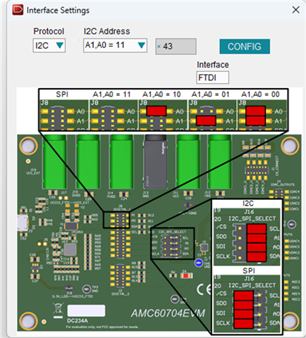

  • Hi Brenden,
    SDA should be pulled up to VIO when no communication is active. Something in the system is pulling it down which is not expected.
    Can you try using SPI mode? Move the corresponding jumpers on J16 to the left side to select the SPI signals.

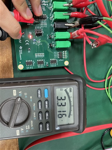

  • After switching to SPI mode, I clicked the “Read All” button, and every value returned 1.
    I then measured the voltages:
    CS and SDO pins stayed at 3.3 V both before and after clicking “Read All.”
    SDI dropped from 3.3 V to 13.5 mV after the click.
    SCLK remained at 1.2 mV the whole time.
    Could the FT4222 or another component have been damaged?
  • Hi Brenden,
    Make sure to enable the SDO pin in the GUI when reading using SPI. The SDO pin is disabled by default. I think the GUI does send a command to enable this on startup, but just in case also try sending the SDO enable command once before reading.

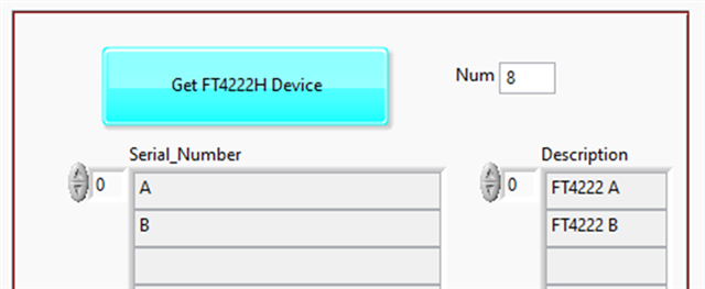

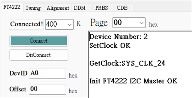

  • Hi Katlynne,
    Since after viewing that python code, I found that our company already had GUI have the same function as the code you provided, so I run these two GUI to read chip id from FT4222, based on the result, I believe the FT4222 works fine, maybe AMC60704 have been damaged? Thanks.
    Brenden
  • Hi Brenden,
    The best way to confirm that the FTDI controller is working is to remove all connections to the device (remove jumpers on J16) and measure the I2C or SPI signals on a scope to ensure they are actually toggling out with the commands from wither the GUI or python code. It's hard to verify this with a voltmeter as the I2C signals are pretty fast.
    If you confirm that you see the signals, then I would agree that the AMC60704 is the problem and is not responding to communication.
    Katlynne Jones

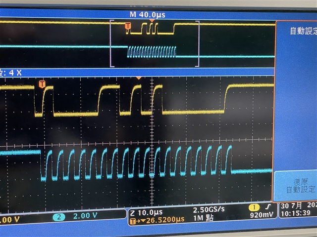

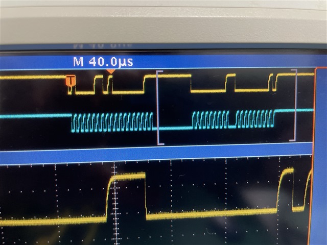

  • Hi Katlynne,
    After removing all jumpers on J16, the I2C signal correctly been measured by the scope.
    Below was the waveform after clicking "Read All" button.
    Below was the waveform after clicking "LDAC" button.
    If I didn't remove those jumpers, the waveform cannot be measured.
    I removed the power supply jumper for FT4222 (J18) and use the development board to send the I2C command directly to AMC60704 and found that the AMC60704 didn't ACK, so based on these measured results, I believe the AMC60704 was damaged.
    I wonder if we can get another EVM? Since we'll use this chip in our future product development, I need to verify if AMC60704 able to work well in our circuit. Thank you!
    Brenden
