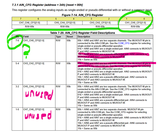

    Note 1: I just found out that I can’t use pseudo-differential mode for (AIN2/3) because AIN3 is with 1.5V out of Spec.
    Note 2: There is an error in the data sheet. Is CH1_CH0_CFG at position 0 as in Figure 7-14 or Bit 6-7 as in Table 7-20? (green pen)

    I assume that I need CH1_CH0_CFG = 0b10 and CH2_CH3_CFG = 0.
  • Hi Thomas,
    Thanks for pointing out the datasheet error, I will request an update. The large table is correct, that is, bit 7-6 is CH1_CH0_CFG[1:0].

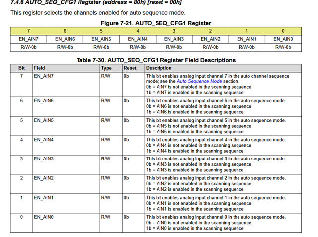

    One thing to try, could you enable only CH0, CH2, CH4, CH6 in auto-sequencing mode when using input pairs? Let me know what the output looks like.

    I will use the single-ended (auto) mode for now; maybe I will implement the pseudo-diff mode later.
