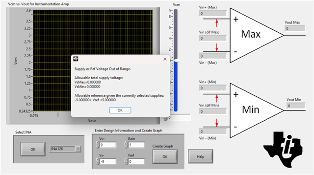

Hello there,
As you can see below, I keep receiving this message, no matter what values I use. Also, the "Select INA" allows me to type a value but the drop box menu is not working, so I doubt that section is working properly and is giving me the correct instrumentation amplifier information.
Is it a bug or something else I'm missing? The auto-update is on, and I downloaded the software yesterday, so I doubt I'm using an out-of-date version.
Kind regards,
Samuele
  • I reinstalled it now and that solved the issue. I think it had to do something with the installation not being complete under one administrator account on my work laptop. I noticed windows defender blocked some things from being installed on other software so maybe it was the case for this one too...
