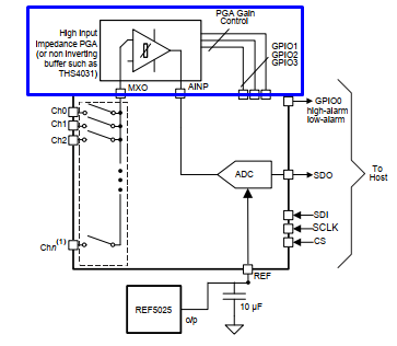

    ① What are the specific advantages of adding an external PGA (e.g., THS4031) to the ADS7956SRHBR?
    Originally, we planned to use the ADC108S022, but since the number of channels to be sampled has increased, we are considering either using two ADC108S022s or a single 10-channel ADC.Our goal is to find a replacement with performance comparable to the ADC108S022, just with two additional channels—primarily for cost considerations.Therefore, considering cost factors, the current design will not include a PGA if the ADS7956SRHBR is used. Without the addition of a PGA, how much impact would there be on the sampling performance compared to the ADC108S022?

    The performance impact really depends on the type of input signal being sample. If it is a DC signal or very slow signal such as temperature, you can likely go without using an amplifier, and it is not strictly required. If the input signal is a dynamic, AC signal, it is best to use an amplifier to help drive the RC input of the ADC at higher sampling rates. If you are getting good performance with your current design, then you likely won't need a separate amplifier. You might just need some adjustments to the input RC values.

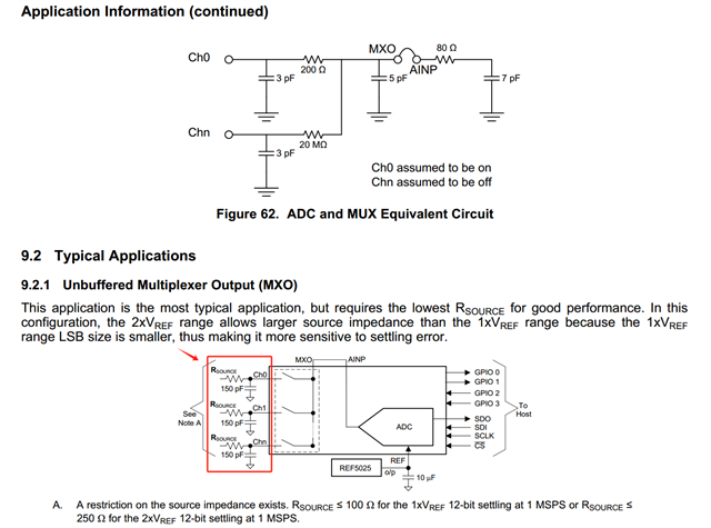

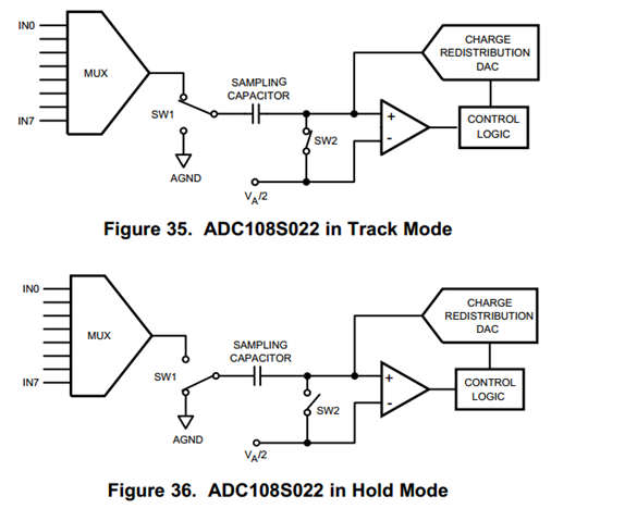

    ① The input side configurations of ADS7956SRHBR and ADC108S022s are different. As shown in the figure, the left side shows ADC108S022s' input with separate track-and-hold modes, while the right side shows ADS7956SRHBR's input without track-and-hold modes. If we replace ADC108S022s with ADS7956SRHBR, do we need to add or reserve additional RC hold circuits on the input side? Our original design simply connects DC voltage (after being divided by kΩ-level resistors) directly to the ADC input pins (CH0~CHn) without any RC hold circuits.

    It is a good idea to add an input RC filter, even when measuring DC voltages. For more detail, watch the Driving SAR ADC without amplifiers TI Precision Labs video. It also gives good advice to the selection of input RC values.
