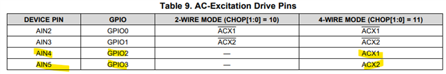

    I am also trying to use AC exication mode. I can see the square wave with my ADC data, but i cannot see any difference in Vpp, i tried floating and connecting resistors there.

    DO i need to use ADS1261EVM pins EXC_out- and EXT_out+, or are those interconnected to AIN2 and AIN3 pins?

  • Hi Yukio Kato,
    You need EXC+ and EXC- output FOR AC excitation on ADS1261EVM. A4 and A5 are used to control the EXC+ and EXC- through U1 UCC27524 on the EVM board by default, please see the schematic below.
    You also need to set these pins to GPIO to control UCC27524 or UCC27523 if you installed and replaced it.

  • Hi Yukio Kato,
    Can you provide a picture of how you have your system connected? A high resolution picture would be best showing the sensor (resistor) and all of the wiring connections to the ADC.
    Regarding the register settings: the footnote in the image Dale provided tells you what to do (enable ACX1 and ACX2 GPIOs). These are GPIO2 and GPIO3 on the ADS1261, which are connected to AIN4 and AIN5 respectively
    You should connect these GPIOs to the appropriate analog input and set them as outputs in the MODE2 register
