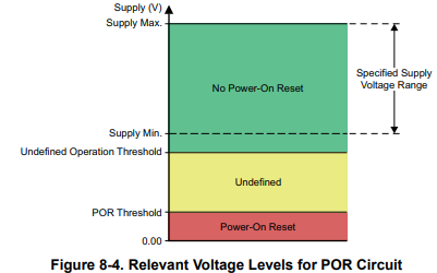

    7. I'm sorry I had missed this original question. However, I'm not sure what you're asking about for the power-on reset. The data sheet describes this reset in detail on page 31-32. If the power supplies momentarily drop or brown out, then the device resets as long as the DVDD is below 0.8V for about 1ms. For the AVDD supply, this POR threshold is 1V and also takes about 1ms to reset.
    Joseph Wu
    I got that if DVDD/AVDD are below the POR threshold voltage about 1ms, they will be reset .Thank you fror your explanation.
    After reset condition, I'd like to confirm how long it will take for the reset to be released,when DVDD changes above 0.8V(POR threshold) and AVDD changes above 1V(POR threshold) .
    ttd

  • TTD,
    I did want to point out Figure 8-4 in the data sheet (page 32). From this figure, you need to reach the operation threshold to make sure you are finished with the POR. Here is the figure:
    In this figure, you need to get the supply into the green area to make sure the device is operating after a POR. The lower bound would be 2.4V for the DVDD, and 8V for the AVDD.
    After the device comes out of POR, we don't list an amount of time required to set up the device. However, I would use 200us as a wait time after POR. This is the time used for the DAC8775, which is a similar device. This time is needed to allow for the trim registers to be loaded into operation.
    Joseph Wu
    →To summarize, is the following interpretation correct?
     "The release voltage for the DAC8760 is unknown. For reference, the DAC8775 requires a minimum wait time of 200 μs from reset release to register access, so the DAC8760 also has a wait time of at least that long."

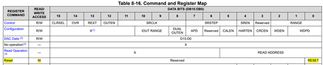

  • ttd,
    Q11
    How long does it take for the RESET bit in the reset register to transition from 1 to 0 after setting 1?
    I believe that various register settings will not be correctly reflected until after the reset is complete. For this reason, I plan to introduce a fixed wait period after inputting a 1 to the RESET bit.
    When setting the reset bit in the register, the register will reset. When you read back the register the value will have been reset back to 0.
    Yes that is correct.

  • Hi Joseph Wu,
    Thank you for your reply.
    →Dose it mean that user needs to read back RESET register(0x56 DB0) after setting RESET=1, and if read back value of RESET is "0", all register resets are done ?
    ttd
  • ttd,
    The software reset should be rather fast, but yes, if you are able to read back the default 0 bit of the reset register, the device should be done.
    Joseph Wu
  • Hi Joseph Wu,
    Upon rechecking reset register 0x56 DB0, it seems to be Write Only. So I can't read back reset register from 1 to 0(complete reset / normal operation).
    Also, I found a past post suggesting a 40ns wait is necessary. Can I use this as a reference?

    Just to confirm.
    Based on your answer, since “reset execution via the reset register means power-on,” is it correct to understand that when reset is executed via the reset register, the next frame becomes the “first frame after power-on”?
    ttd
  • ttd,
    I think the reset should take <1ms to complete. However, I'm checking with design to get a more complete answer. Give me a couple of days for me to get an answer from them.
    Joseph Wu
  • Hi Joseph Wu,
    I'm looking forward to your reply for my additional two question about rest.
    ttd
  • ttd,
    I did talk to one of the digital designers. He said that said that you should not look to read back from the reset register to check the reset time. A more valid way of checking the reset is to read back from a different register that has been set to a non-default value to see that the reset is back to the default value. This would be a better way to check the reset completion.
    However, to after writing to the reset register, there is a delay of a few hundred microseconds to complete the reset. This is based on an analog circuit that would take a maximum of 400us to complete. From the digital, the reset would take less than 10us to propagate to the registers. The sum of these times would be the total time to complete the reset.
    The issue of a NOP command after a reset command is not necessary. We recommend issuing a NOP command after power up because there may be unusual transients on the SPI signal lines after power up that might be interpreted as communication. Unless there are unusual transients at the digital lines, the NOP is not needed.
    Joseph Wu
  • Hi Joseph Wu,
    →I understand that 410us(400us for analog and 10us for digital) is the time to complete the reset.
    →I understand that your comment is for regarding the initial Q12 response about whether the NOOP command is necessary.
        Also, are NOOP and NOP the same thing?

    Q28
    Regarding Table 8-16,
    What data is read when reading the register bits marked “X” (don't care bits) and “Reserved”?
    ttd
  • ttd,
    Q24. A NOP is basically a "no operation" command. It is the red box that you enclosed in the copy of Figure 7-2 that I had used in the previous post. In the DAC8760 it is at address byte 0x00. To execute the NOP, you send in 0x000000 to the device (0x00000000 if CRC is enabled).
    The NOP is used to clock out the data when a read register command is sent. That is basically its only function. The point is that during a read, you do not want to be using another command to clock out the data. The customer's sequence is fine. In their sequence, it seems they want to write to registers and readback the registers that were written. When they do read back the registers, they should just make sure they use NOPs to clock out the read data.
    Q28. For these registers, the NOP, the read operation, the RESET, the Watchdog timer reset, and CRC fault are not registers that are readable. For the configuration register (bits 15:11) and the status (bits 15:5), they are either don't care or reserved. This means they should not be used for anything by the customer. I don't think they are programmed to output anything in particular and the output may be random.
