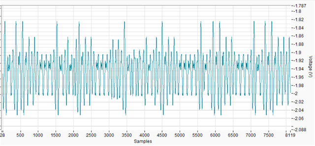

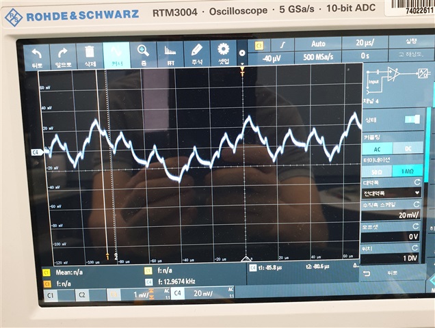

I have very noise pattern at VOUTP pin as follows
When I set address 0 -> 0x00(Sine mode) , I have very low noise normal sine wave pattern.
Please recommend me,for removing below noise pattern at DC mode
  • Hello Jonghu Ju,
    Welcome to the TI E2E community!

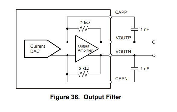

    The DAC1282 has about 200mVpp of noise with a fundamental frequency of about 8kHz.  This is normal behavior for the ADC.  It is intended to be used with a high precision delta-sigma ADC with a digital filter bandwidth of about 420Hz.
    If you want to use this DAC for general purpose applications, then you will need to add an analog output filter.  First, make sure to include the output capacitors, as these provide a first stage filter using 1nF C0G ceramic capacitors.

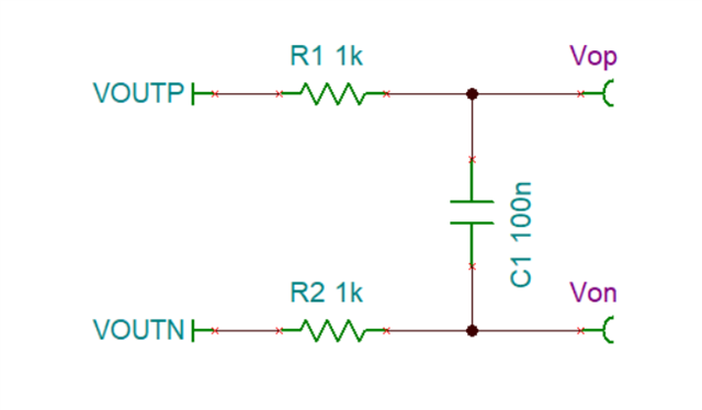

    You can add an additional differential output filter as shown below to further reduce the DAC output noise.
