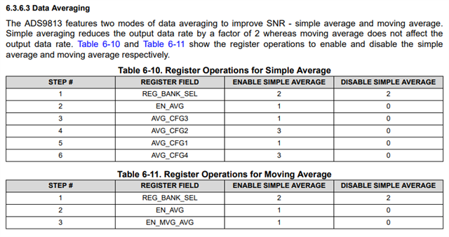

    2. Yes, the device does have oversampling (simple average) by a factor of 2x. It can be accessed using the below register:

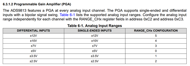

    4. The ADS9811 has a PGA on the front-end that may be used to set the appropriate range:
      1. The device does not have any additional phase or offset calibration, but this may be calibrated for at a system level as shown in this video: https://www.youtube.com/watch?v=zARSuyJtHYg

    7. Regarding data averaging, is the understanding below correct?
    Three points are possible for a simple average and two points are possible for a moving average.

    7) In simple average mode: first sample (s1) is a average of n and n+1 data. Next sample (s2) is average of n+2 and n+3 data. For each averaged output, two data sets need to be sampled, so data rate is reduced by factor 2.
    In moving average mode, each sample is the average of current sample (n) and previous sample (n-1). Additional data is not sampled, so data rate is not reduced.
    8) In simple average mode, the data will take double the time as shown in bullet (5). So for 4-SDO DDR mode, it will take 48DCLKs, or instead of 1MSPS, data rate will be reduced to 500ksps.
    In moving average, the data rate will remain 1MSPS.
    9) The device is currently only capable of doing 2 point averaging. What is the urgency of 4 point averaging? I can check with the team if this is possible. Does customer need 4 point moving average or simple average?

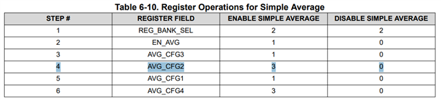

    What does "ENABLE SIMPLE AVERAGE" in table 6-10 mean? I thought "3" means that the device can support 3-point averaging in simple average.

    This table is showing what values to write into these registers to enable simple average mode. 6 registers, as shown in the Table 6-10, must be written to enable or disable simple average mode. All of these writes will enable averaging by a factor of 2.
