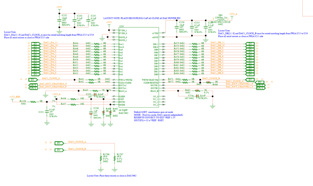

Please help to review schematic for DAC5662 as below.
DAC5562 will connect to FPGA.

Please follow the datasheet recommendations on the DAC outputs. These outputs need to be terminated properly otherwise, there will no signal on the outputs.
Otherwise, this looks fine.
