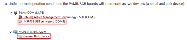

    Currently the PAMB controller is detectable on PC through in two ways a serial and a bulk device, one which would be accessible through putty like you have done, but accessing the bulk would require firmware access which is currently not enabled.

  • Hello Yolanda,
    Oh Interesting!
    I haven't worked with Bulk Devices before and will take my interest offline while I look into this.
    My project timeline doesn't support acquiring a different device, but I will look into your recommendation for the next time.
    Thank again for your input!
    Marking this "Resolved" as in a dead-end trying to use the hardware the way I intend and need to acquire different hardware to achieve the desired behavior as you have outlined.
